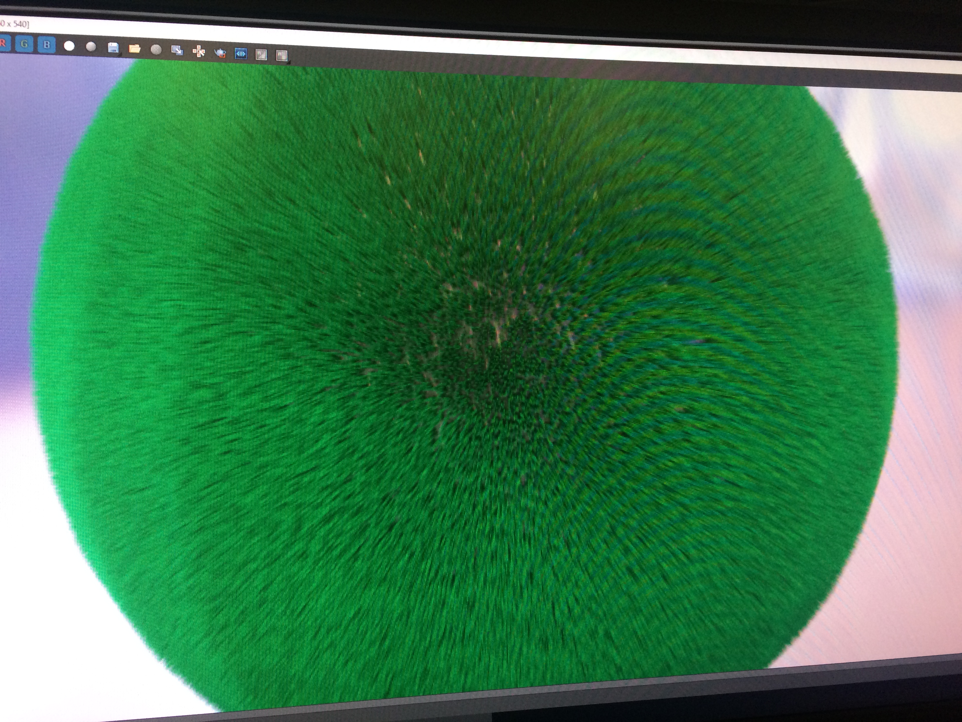

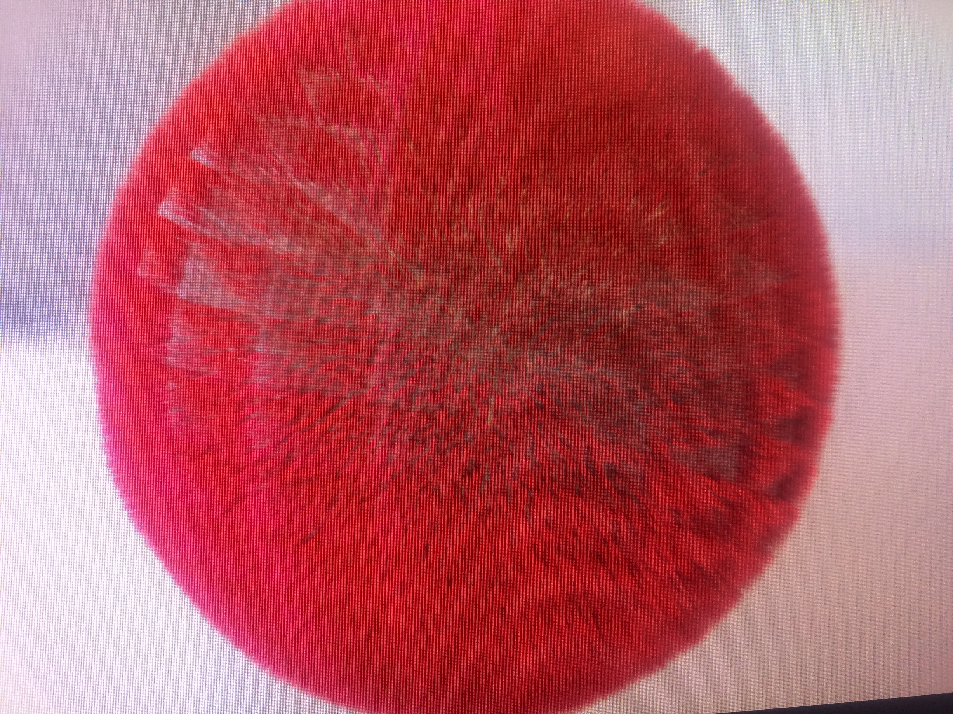

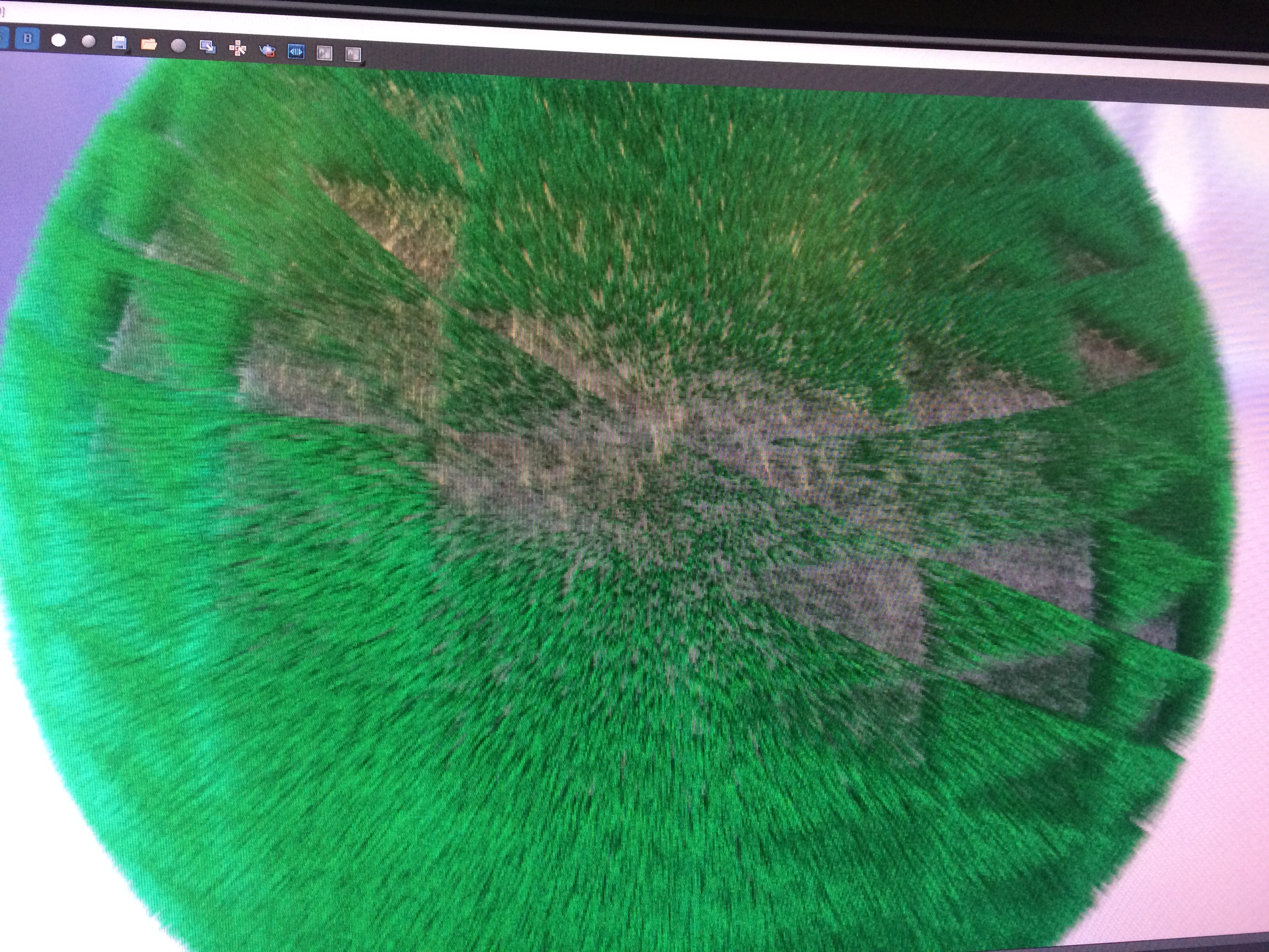

Hi Guys! I dont know why, but when I apply Mesh from strands this issues happens (add image), but if I turn it out the issue gones, do you guys know what I'm doing for this happen? PS: I've tried turn of maya and open again, I've created a new scene, light is a Vray dome light (But I guess that it will happen with any light) but it still happen =Z Best Regards Felipe Luiz |
| PS: with no texture, just a VrayMtl with a color |

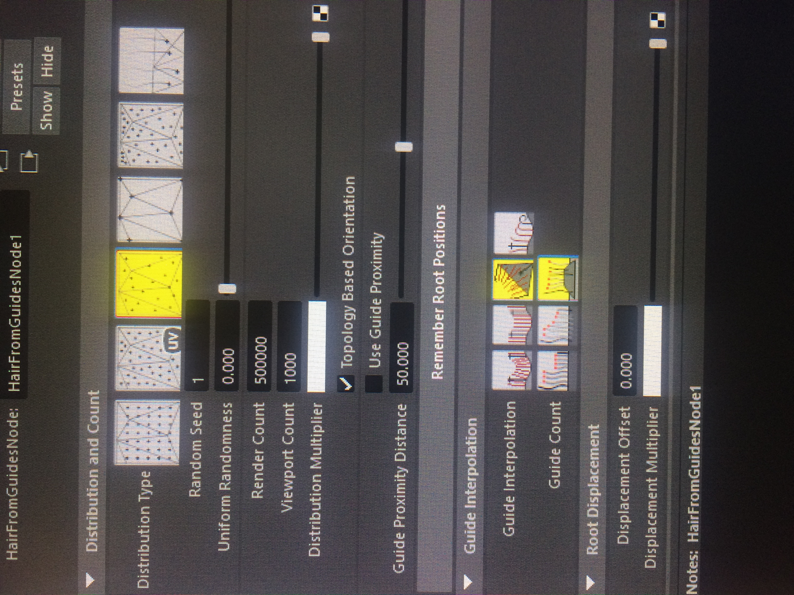

| Hi Felipe, Try using a Random Distribution Type in the Hair From Guides operator. Jeordanis Figuereo (Product Designer. EPHERE Inc.) |
| Hi Jeordanis!! I've used. I'm using default presets from hair from guides and it's random I guess like you can see in added pic |
| and when I turn off mesh from strands everything works fine =\ . however I need the mesh from strands to render texture with vray properly |

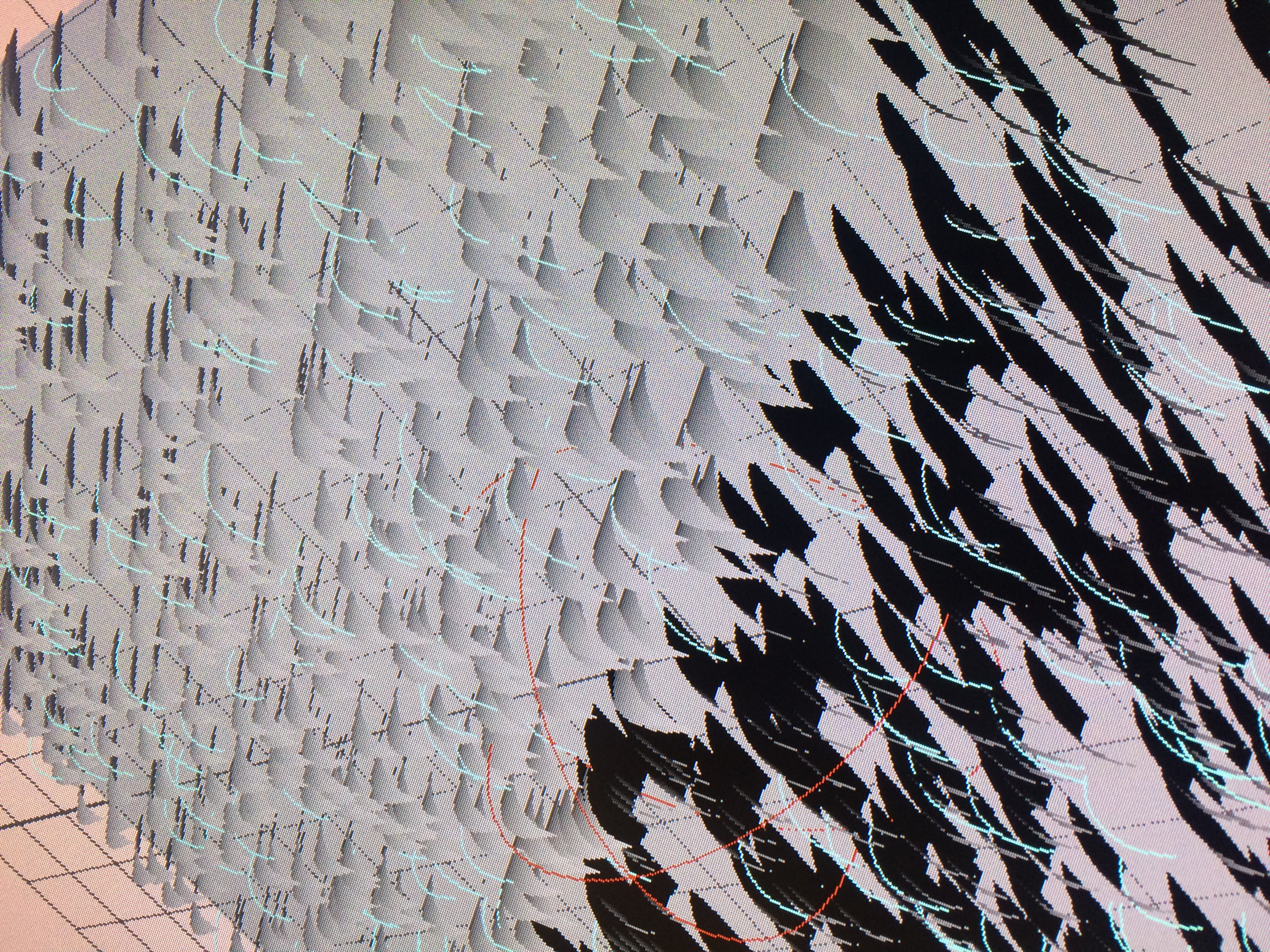

| Hi! I tried with other render engine (maya softwate) and I had the same issue. but when I change the strand mesh type ( in mesh from strands) from flat ribbon strands to cilidrical strands I didn't get the same issue, but the time of render increase by 5 times. so I think the issue could be due the ribbon generations algorthim, becouse it is not using the surface comb directions. you can see at the pic below an example |
| Hi Felipe, Thank you for the update, I will pass this information to the devs. Jeordanis Figuereo (Product Designer. EPHERE Inc.) |

| Hi Felipe, You can turn off Topology Based Orientation in HairFromGuides to get rid of this pattern. Jeordanis Figuereo (Product Designer. EPHERE Inc.) |
