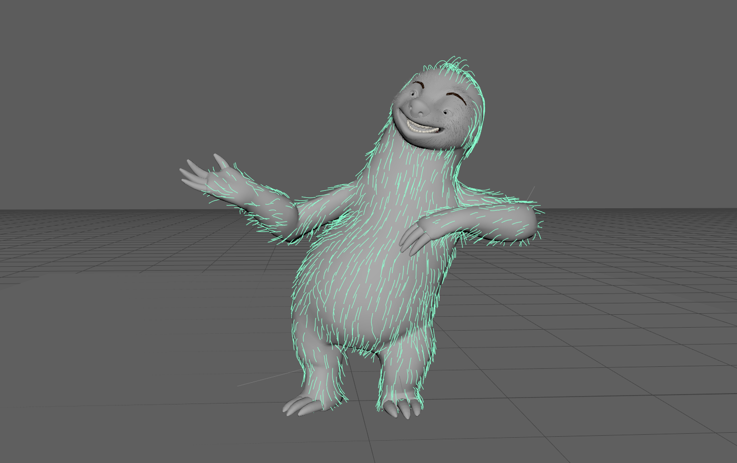

How to solve this problem?
The hair does not refresh when I changed the pose to another.
I have a scalp with wrap deform.

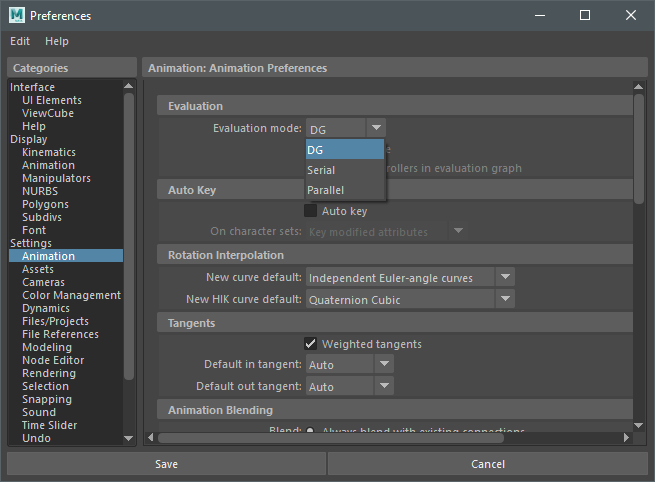

Hi Rick,
Are you playing an animation?
Yes! Playing or just scrubbing the timeline.
Rick Pimentel
3D Artist
rickpimentel.com
@rickmax
You have to change the evaluation mode to DG, parralel mode is not supported yet. Go to Windows - Settings - Preference - Animation.
NICE!!! THANKS!
