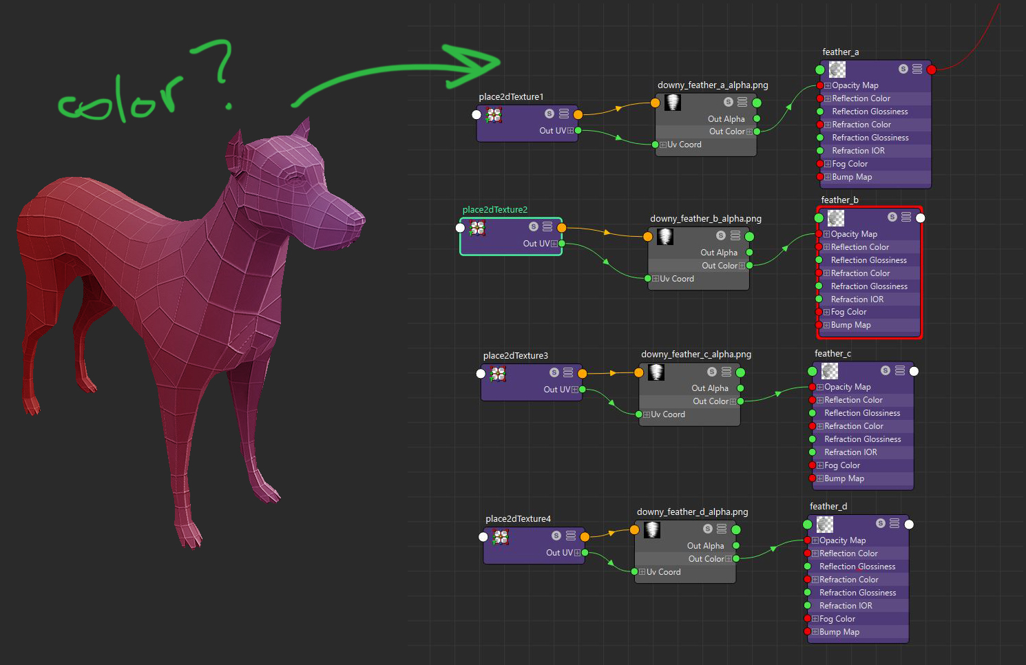

If you take a look at the image I have attached you can imagine the scenario. I've set up 4 shaders with unique feather opacity maps...but then I want those shaders colors to come from the gradient on the model that they are growing from...
So there must be a way to not only mix UV maps like in the above video...but to then have the per-strand textures be mixed or scattered as well.

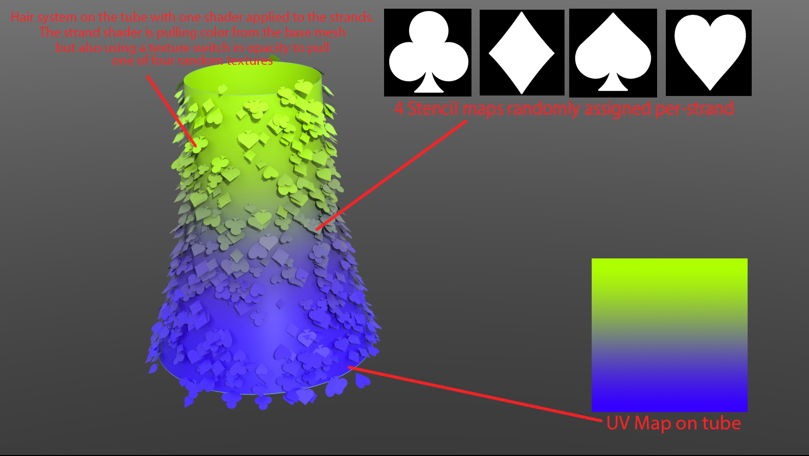

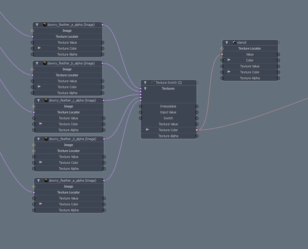

Here is a better example of what I am trying to accomplish. I set this example up quickly in modo (only because I know this program best) but I have to use maya / ornatrix / vray for work. There has to be a way to do this in maya / ornatrix / vray...I already tried mapping a bunch of alpha maps into a ramp in the hypershade to see if it would feed them randomly into the vraymaterial opacity channel. It didn't work. I can't mix shaders becasuse I can't get the color to come from the base mesh then unless there is a way to do so that I have not thought of.
