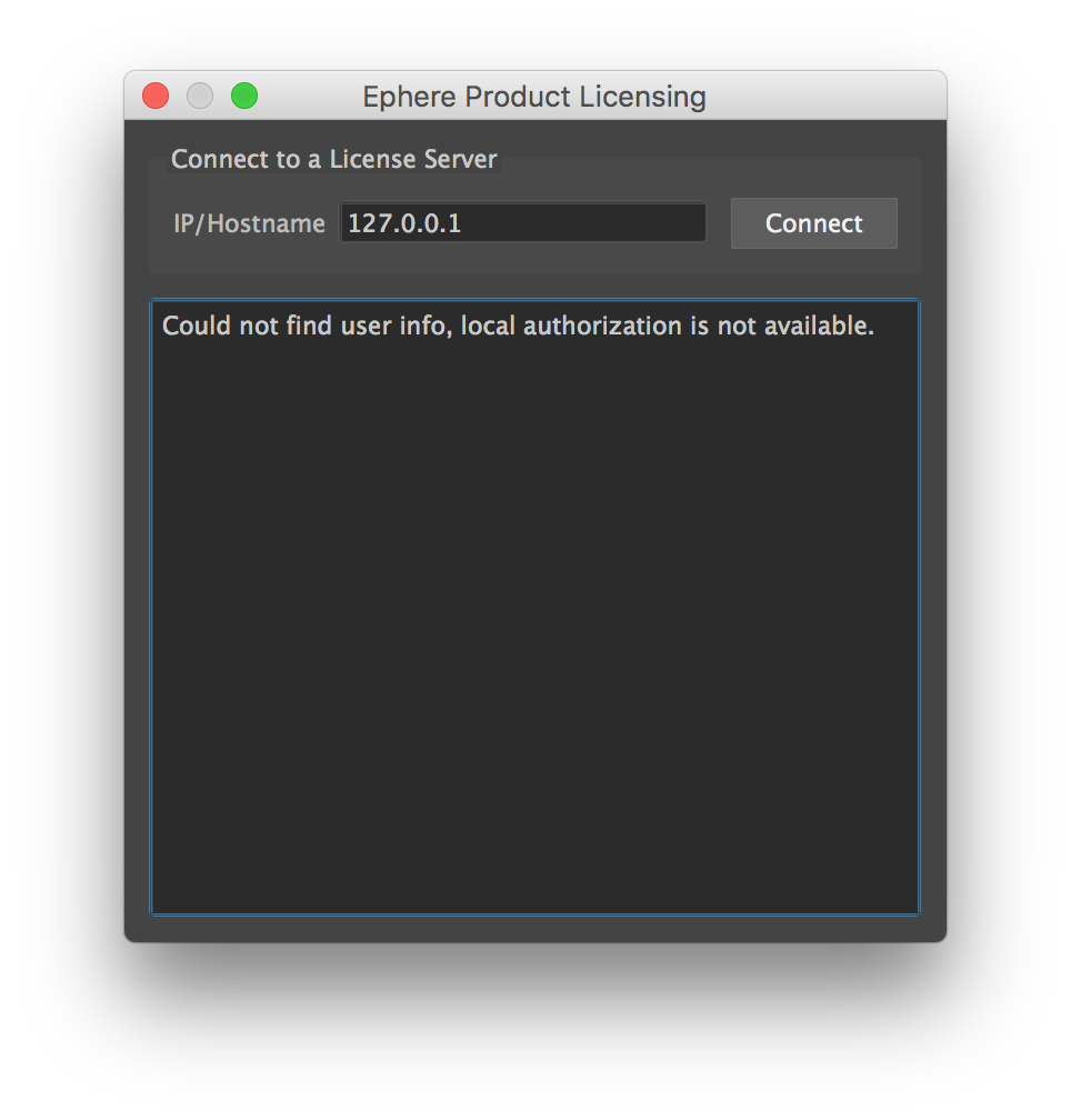

I installed the Ornatrix demo from the downloads page (using the Mac 64-bit .pkg), but can't launch the demo in Maya 2017 as it gives me a licensing error. Screenshot attached.

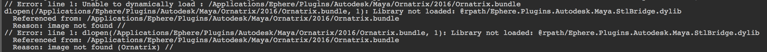

Also, in Maya 2016, the plug-in does not load, but gives another error (also attached)...

Hello there,
Can you please try unistalling the license server? If you have it installed... The demo version should not ask you for a license.
There are a few problems with the demo installer and zip for Mac OS, we'll have to fix these.
Please try again the Demo download (either pkg installer or 7z archive) for the latest 1.2.7 version for Mac, I hope it will work now.
