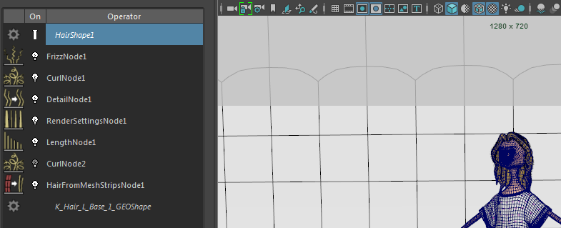

I have a character with hair done using HairFromMeshStrips (Maya 2017 Update 3+ Redshift Experimental 2.5.19). So each clump of hair is a tube that has hair flowing through.
My goal is to render a turntable, so I've created a joint and binded all geometry to it. Now, when I use the rotate manipulator to rotate the joint everything looks light, the hair goes along, but if I set two keyframes on the Rot Y of that joint and play or render the hair stays behind.
Hi Mario,
I've been trying to reproduce this but it seems to be working as expected here, the hair is following the geometry. What version of Ornatrix are you using? Any chance we can have your scene for testing? that would help us a lot. You can send the scene to: Jeordanis.f@ephere.com.
I had to change to DG Eval Mode..... Now it works!
Oh great!
This is mentioned in the Troubleshooting section of the docs: https://ephere.com/plugins/autodesk/maya/ornatrix/docs/1/Guides_or_Hair_Update_Problems.html
