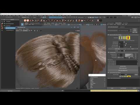

I'm struggling with some groups of hairs. The first image is the troublesome part, the second image are the splines, and the third is my operators stack. Why do the hairs deviate like this, and how can i stop it from happening? I'd like it to be an even curl along the entire horizontal surface.

Sorry for the delay... Have you seen my tutorial about this topic? This is happning because Ornatrix have to interpolate the hairs between those guides, you just have to find the appropriate Hair distribution type and Guide interpolation for this particular case:
