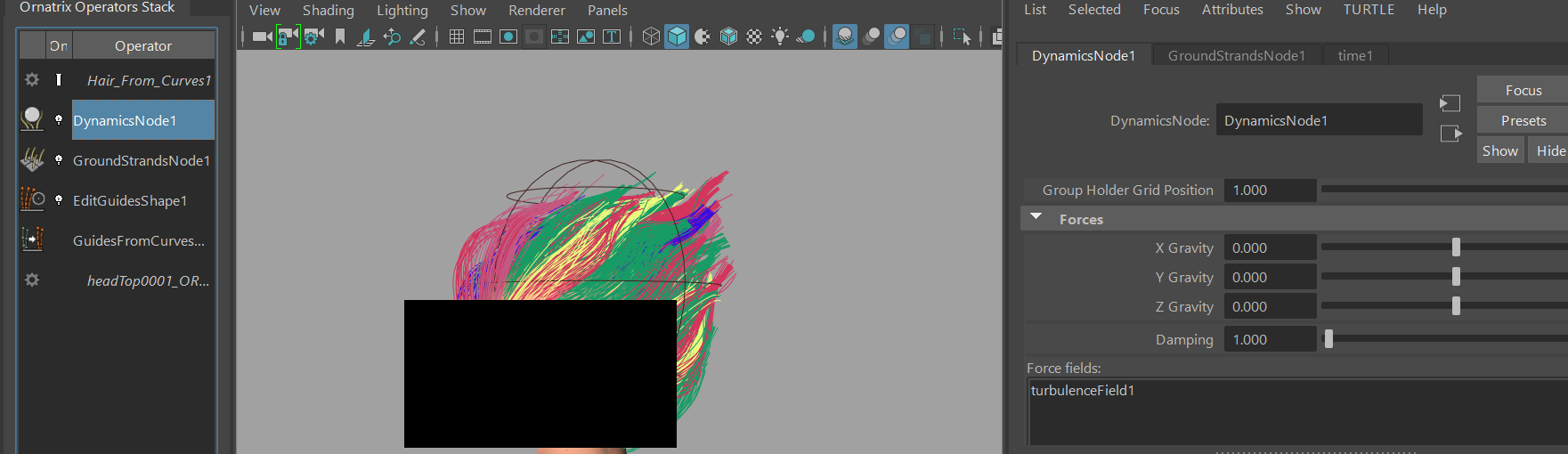

| Hello again,
After playing around a bit more I want to try to group hair into multiple clump( just like this video guide here: https://www.youtube.com/watch?v=8GqaYb5oR-w ). The problem is it is very difficult for me to assign group to each clump when I can't distinguish between the assigned clump and unassigned clump, and especially which clump is assigned to which group. Am I doing something wrong here? I am sure there is a better solution than this. Thank you.

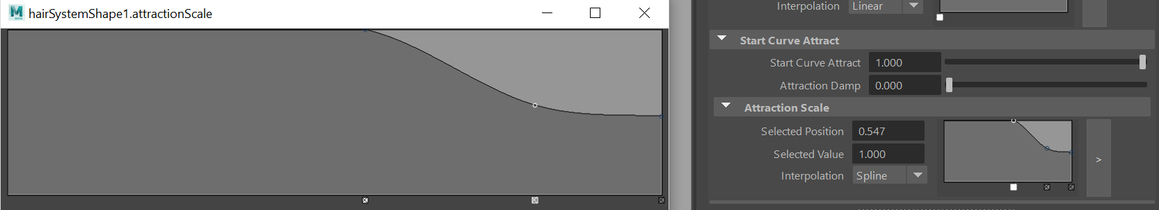

| Hi, hopefully this will be my last question before I buy the license. If I want the base of the hair to be stiff while the tip to be soft, can I achieve that with Ornatrix? With nHair I can achieve this by setting start curve attract and modify its graph: Thank you.
Attached Files: |
| Hello Bird, "After playing around a bit more I want to try to group hair into multiple clump( just like this video guide here: https://www.youtube.com/watch?v=8GqaYb5oR-w ). The problem is it is very difficult for me to assign group to each clump when I can't distinguish between the assigned clump and unassigned clump, and especially which clump is assigned to which group. Am I doing something wrong here? I am sure there is a better solution than this. Thank you." You can't see the strand groups/IDs because those are only visible in Viewport 2.0, you are using Legacy Viewport. You should see each strand group represented by a different color. Btw, instead of using the strand groups channel, I suggest that you create a new guide channel called "Parting" or something like that, then create your groups there. This way you have a channel dedicated to parting only and is all more organized. Just a suggestion. "If I want the base of the hair to be stiff while the tip to be soft, can I achieve that with Ornatrix? With nHair I can achieve this by setting start curve attract and modify its graph:" If I understand correctly, in the video you linked you can see how Marsel used the Group Holder Grid Position parameter to achieve what you described. Am I right? Jeordanis Figuereo (Product Designer. EPHERE Inc.) |
| Hello again Jeordanis,
Yes I am talking about the hair simulation.
| About the 'Group Holder Grid Position parameter' if I understand correctly it allows the tip of the hair group to move freely individually which is not what I am looking for. I want the hair to move together as a group from base to tip ( I need a pointy hair tip ) but dynamically softer around the tip area. |
| Oh I see... We don't have this feature at the moment. But we might include it in future versions of the Dynamics node. Jeordanis Figuereo (Product Designer. EPHERE Inc.) |

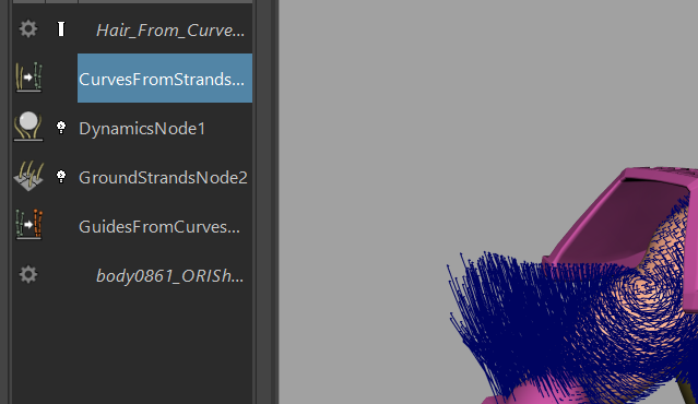

| Hello again.
I tried to export my simulated curve with the method you mentioned earlier with curves from strands mode. However it seems that the ground srands node is no longer working. I need to export the curve which attached to the skin. How can I do that? Thanks.
Attached Files: |
| You should ground strand inmediatelly after GuidesFromCurves or ANY editing. Try using the Dynamics node on top of GroundStrands. Jeordanis Figuereo (Product Designer. EPHERE Inc.) |

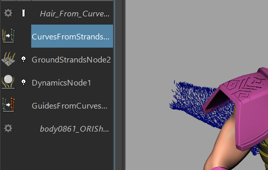

| Hello again, 2 things: 1. It still doesn't work.
2. When I have Dynamic Node after the ground strand when I tried to use 'collide with surface' the dynamic became a bit wierd and some hair started to flicker.
 Attached Files: |
| Sorry for the delay. Can I have your scene for testing? The Ground Strands node should be working fine, I can try to improve the simulation too. If possible, you ca ln send the wcene to: jeordanis.f@ephere.com. Jeordanis Figuereo (Product Designer. EPHERE Inc.) |

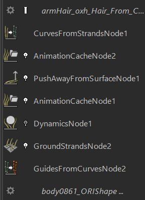

| Hello Jeordanis, Sorry for disappearing for quite a while. My work is confidential so I can not send the scene over. Since my deadline was close I decided to not visit the forum and tried to finish the shot with ornatrix with the best of my ability. Facing a lot of technical difficulties, I will try my best to describe the problems which I hope will be helpful to the developers.
I will start with my set up :
 So I started off with a guide curve from client, I convert them to ornatrix guide by select the curves then 'add hair'. To simulate I apply a 'dynamic node' on top of 'ground stand node'. Lastly, before applying 'curve from strands node' I use 'animation cache node' to convert simulation into cache. The first problem I noticed is that the order of the curve I selected to convert into ornatrix guide and the order of curve generated from 'Curves From Strands Node' is different. Meaning I cannot apply the animation from ornatrix simulation back to client's guide curve even if the number of span is the same. Now the Dynamic node :

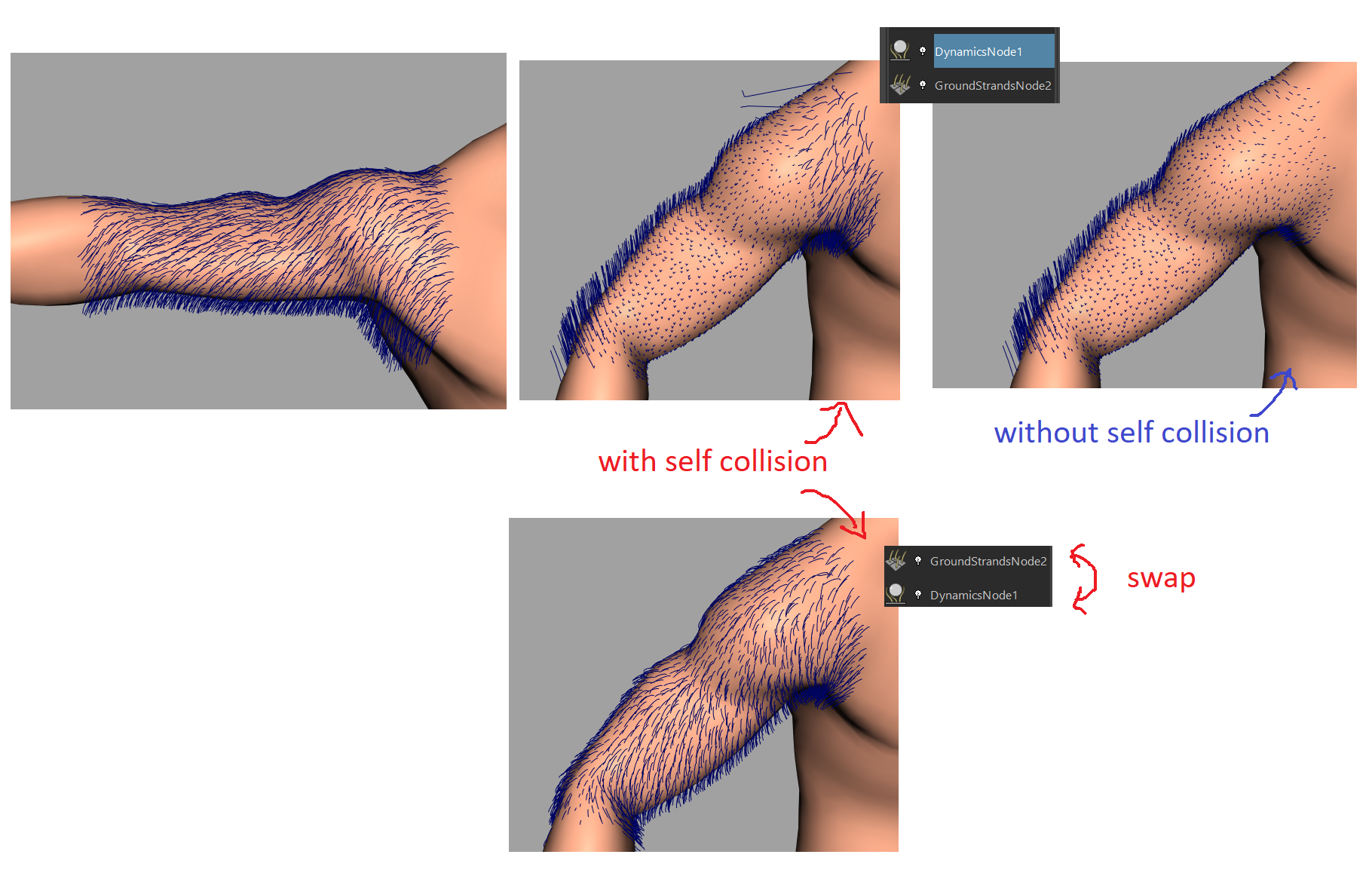

Self collision :
 When I put 'dynamic node' on top of 'ground stands node', when I turn on self collision the simulation gets weird. In the picture above, the character only move from T-Pose to shot pose which is nothing extreme and the simulation is apparently got very weird. However, sometimes when I have 'dynamic node' under 'ground stands node' the simulation tends to get a little bit more stable.

| Hi Bird, "The first problem I noticed is that the order of the curve I selected to convert into ornatrix guide and the order of curve generated from 'Curves From Strands Node' is different. Meaning I cannot apply the animation from ornatrix simulation back to client's guide curve even if the number of span is the same." This is to be expected. CurvesFromStrand will generate a different set of curves with the animation on it, the animation will be applied to the Ox generated curves, not the source curves, this is how it works. In my first two messages I explained the workflow to exported the curves and animation generated by Ox, I didn't described a way to import the animation into the source curves, sorry If I confused you there. I expect that you where going to use the resultant Ox animated curves with the same amount of points for the final results. About the Dynamics node. Is very difficult to advice you if I cannot look into the scene. Now that I think about it, the GroundStrands node is only needed if you are going to generate hair from those guides, which you are not going to do, you don't need it. This node affect the rotation of the guides, better don't use it on this case. Another cause of the issue can be something in the PushAwayFromSurface node, but is difficult to say without looking into the scece. To make the simulation a little bit more stable at the roots try playing with the Holder Particle Position parameter. This will move the initial particle at the roots, maybe this can help. I'll see if Marsel can give you more information and details about Moov. Jeordanis Figuereo (Product Designer. EPHERE Inc.) |
