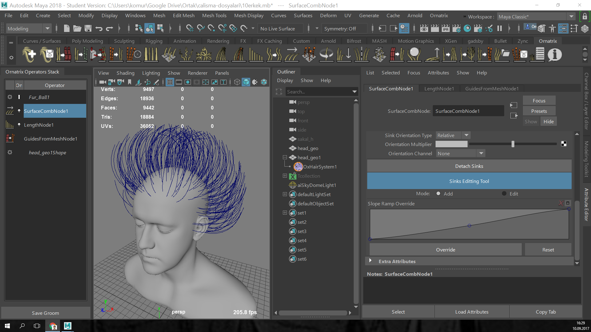

Hi Everyone, I do have a little dumb question, I dont know why but i couldnt figure out, so i was watching this video and go along with video ( https://www.youtube.com/watch?v=-RLN-wE47zw ) whenever he click sinks editting tool he can make surface comb node work but whenever i click sinks editting tool and click on mesh its select my bald cap mesh I am using trial version btw. * I also add screen capture in case you need Thank you everyone! |
| Hi Ömercan, It seems like you forgot to upload the screen capture. I just tried here and it's working fine, I used the demo version 1.3.1.12011. Make sure you have the Sink Editing Tool in Add mode instead of Edit Mode. Jeordanis Figuereo (Product Designer. EPHERE Inc.) |
| silly me, i forget to press upload :) so this scene. |
| Oh, I see you are using Maya 2018. I was able to reproduce this problem there, it's working fine in Maya 2017 though. We'll fix this asap. Thank you for the report. Jeordanis Figuereo (Product Designer. EPHERE Inc.) |
| This issue has been fixed in build 12194 and up. I'm not sure if you have access to nightly builds, if so, please give it a try and let us know. Jeordanis Figuereo (Product Designer. EPHERE Inc.) |
