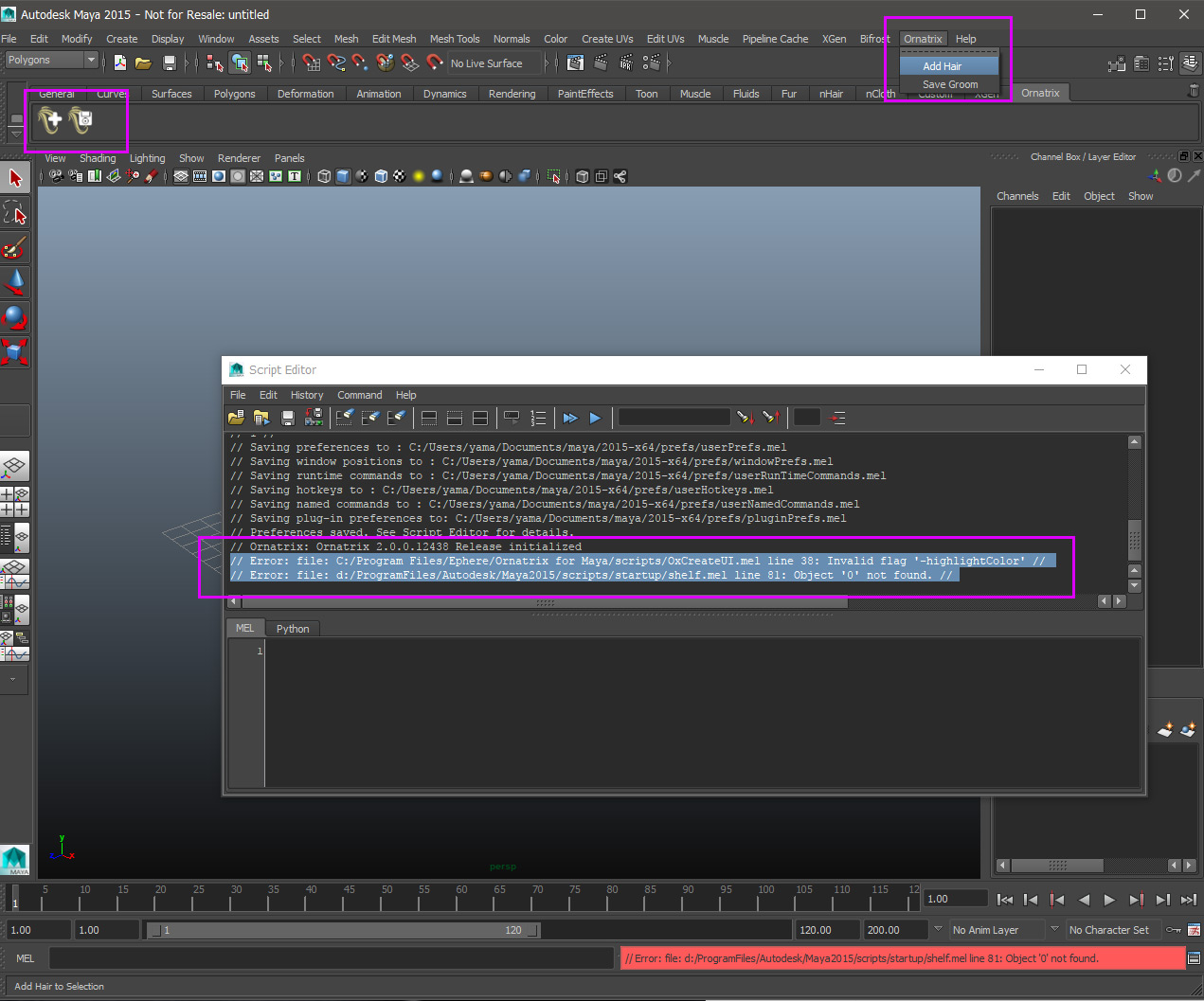

Ornatrix Maya v2 BETA can not be plugged in Maya 2015. (same maschine maya2017 no problem)
testing environment:
Maya 2015 SP6 Windows 10
Ornatrix Maya 2 Beta
2.0.0.12423 [Latest Stable] / 2.0.0.12438 [Nightly] same
following error message
// Error: file: C:/Program Files/Ephere/Ornatrix for Maya/scripts/OxCreateUI.mel line 38: Invalid flag '-highlightColor' //
// Error: file: d:/ProgramFiles/Autodesk/Maya2015/scripts/startup/shelf.mel line 81: Object '0' not found. //
plase check.
OakCorp [Japan]
Yuji Yamauchi
Hi Yuji,
Thank you for the report.  We will look into this.
Hi Yuji,
This has been fixed for build 12458 which will be online soon. Please give it a try.

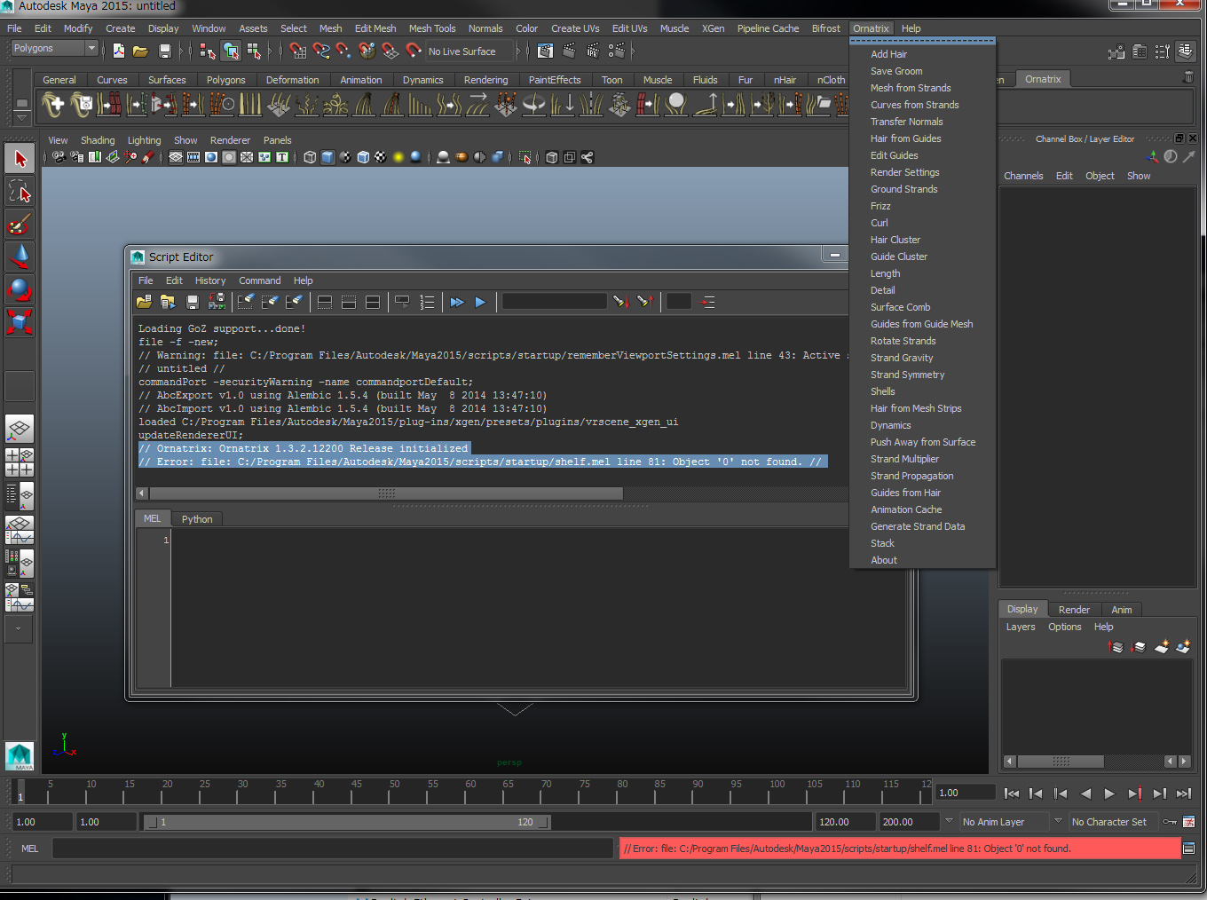

Helf matches in ver1.But error massages occur.

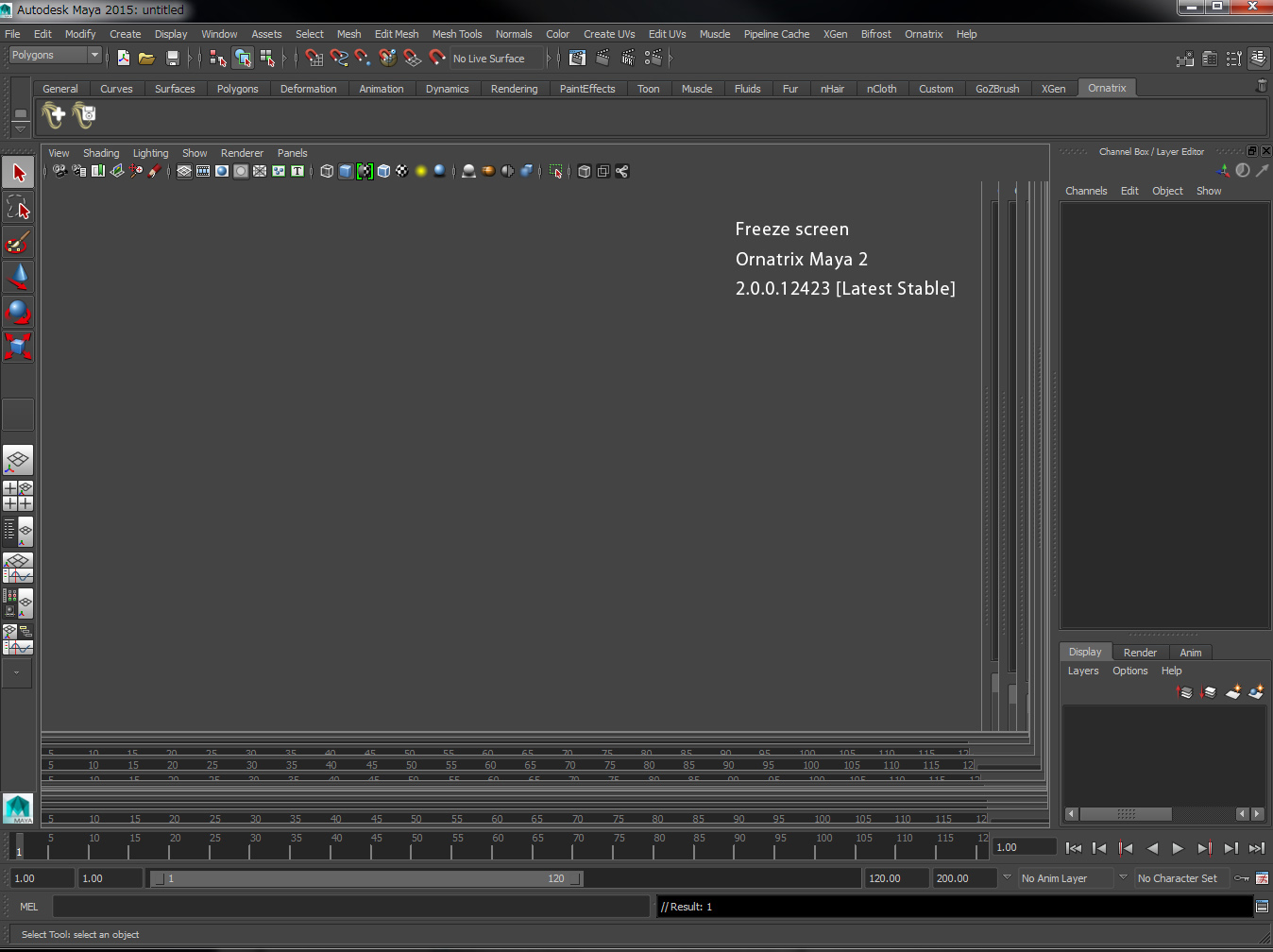

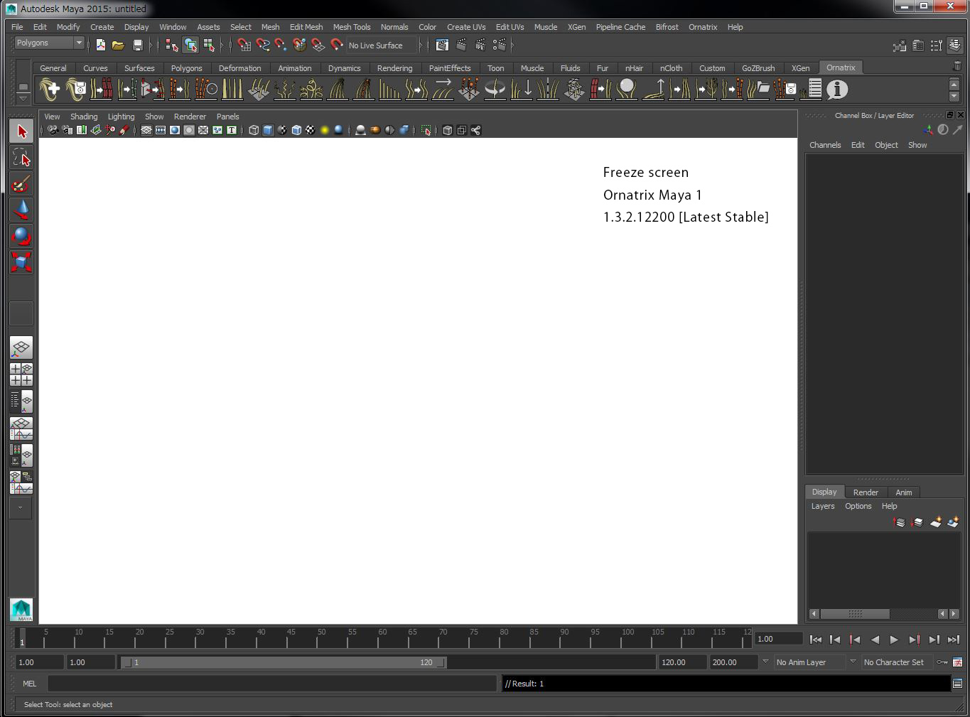

Other ploblems are to freeze by both of ver1 and ver2 in caseof an end of maya2015.
Maya 2015 SP6 Windows 7
2.0.0.12423 [Latest Stable] / 2.0.0.12438 [Nightly] sameOrnatrix Maya 1
1.3.2.12200 [Latest Stable]
Image 1Image 2
Hi Hide,
Thank you for the report. Can you give me more details? like, what are you doing with Ornatrix when Maya freezes? are you executing a particular command?
The command isn't being carried out.
Ornatrix is just started from plugin manager  and it's frozen at the time of a maya end.
This is confirmed, we're investigating it.
