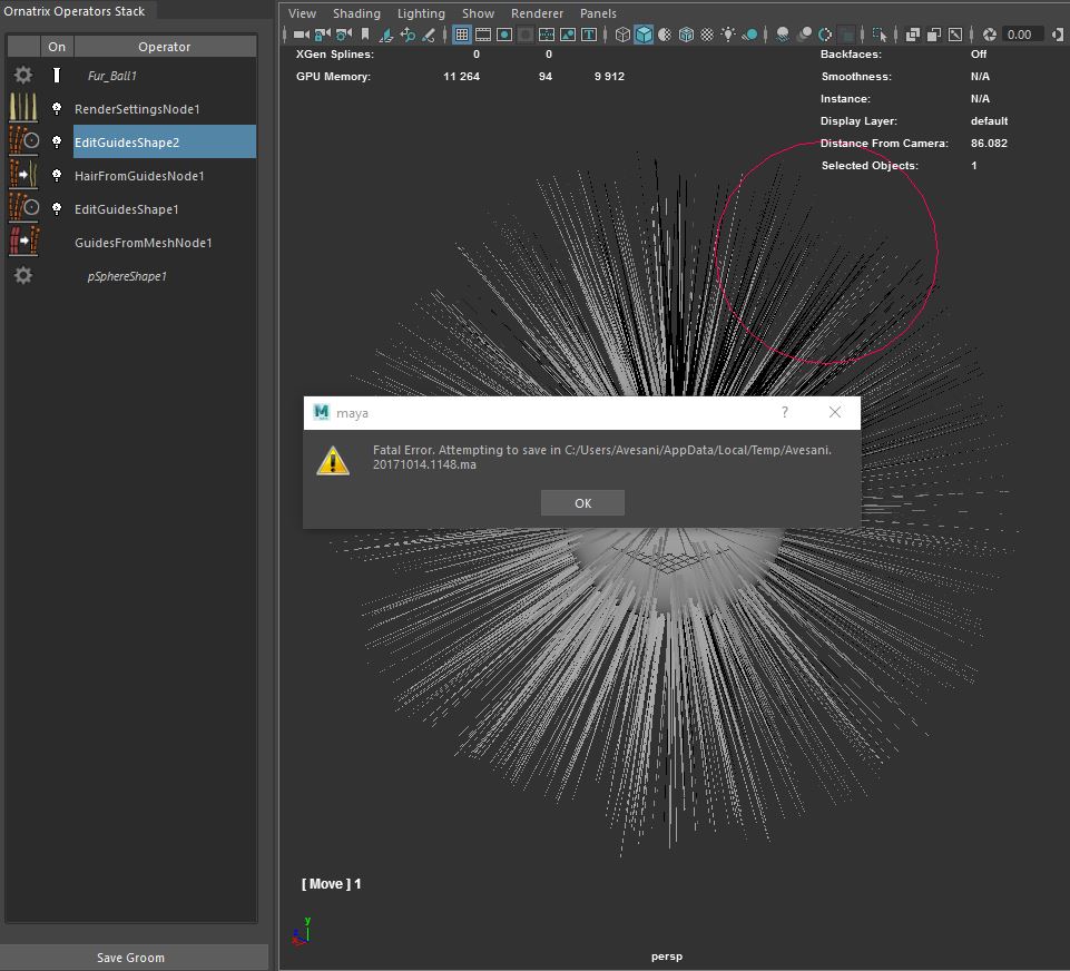

Hi, aways im try use EdiGuide node, crash maya 2017 and 2018, what may be the problem? Thx
Diego Avesani
Hi Diego,
This is because you are using EditGuides in top of hair. Edit Guides is only used to manipulate the guides, you should always use it under HairFromGuides.

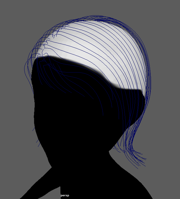

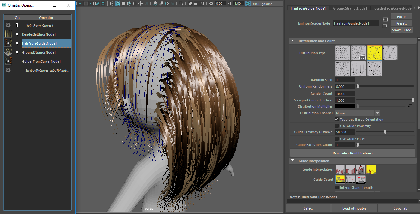

Nice Jeordanis, I'm seeing the documentation and channels, but I'm not really understanding the distribution type, using curves, I can not find a solution, what am I doing wrong? the only way I found it was using type distribution (guide as hair) but I can not put more amount of hair nor edit. my scalp is wrong?
thx you again :)
Diego Avesani
You want the hair to follow the guides as close as possible, right? Paint your distribution mask very close to the guides, use a separate scalp/distribution mesh for the hair, don't use the body, a smaller distribution area will give you a more accurate hair count and distribution, then for Guide Interpolation try Affine, for Guide Count try Between Two Guides and Three guides.
