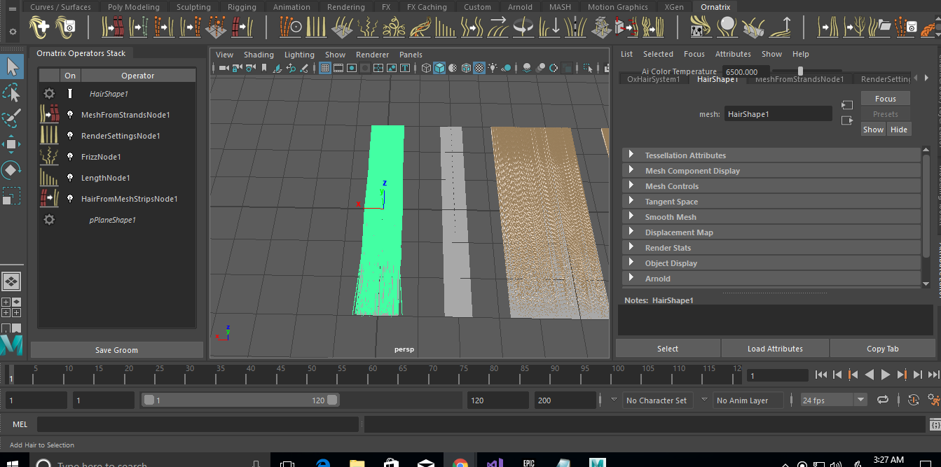

Sorry, title should be help with clustering, not clumping. Screenshot of my toolbar. its not there even i scroll down either.
This is because I used Ornatrix v1 in the video and you are using Ornatrix v2 beta. Hair Clustering and Guide Clustering node has been replaced with the Clumping node in Ornatrix Maya v2 Beta. We don't recommend using v2 beta in production, every new feature is subject to change and some of them are experimental. You can follow the steps using the Clumping node, however we still don't have any documentation about the Clumping node because this is still in development and will probably change quite a bit.
Wow thank you. I didnt realize i was using the beta version. I will download the v1 version for use. Thanks for replying!
No problem. Let me know if you have further questions.
