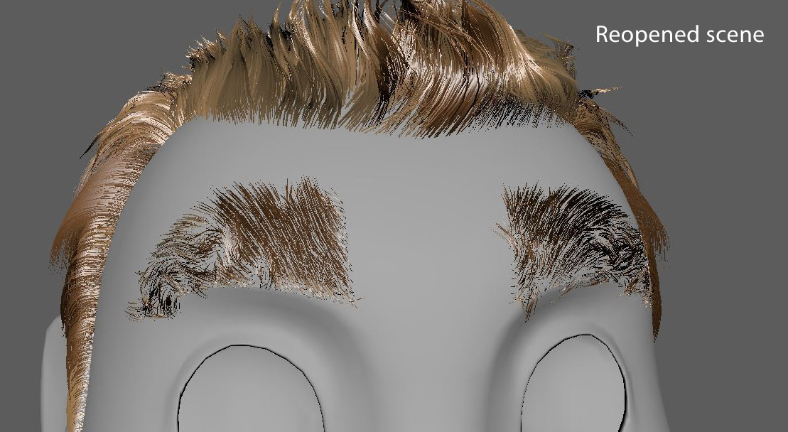

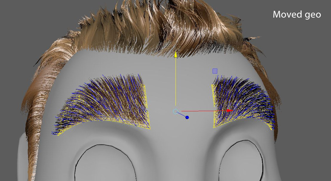

I'm trying to move down the geomtry for the brows that were created for this character. Essentially I make the head geo 'live', select and move the points or polys of the brows geo that the Ornatrix hair was created on to where I want it, and turn of the head geo 'live'. Everything looks fine until I save the scene and reopen it.
I've tried duplicating the geo for the brows, move that, and with the 'Add Ground Strangs' node reapply the hair to that moved mesh. It applies, but the guides go "wonky" like mentioned above.
The other option I tried was creating a preset with the groomed brows and applying that to the moved geo, but same thing happens.
For a production pipeline, there would seem to have to be a way to update (i.e. move) mesh that has Ornatrix hair created on it. Any help on this would be greatly appreciated.
P.s. I'm using version 2.0.1.12610
I tried to update to newer versions, but just opening the scene with the newer version messed up the groom on other parts of the charcter.

Hi Jeordanis,
Thank you for the follow up. I've tried what you've recommended and once I deslect 'Rember Roots Position' on the GuidesFromMesh node after moving the geo, the guides "explode" and go all over the place. I tried it with the brow geo (distribution mesh) wrapped to the head and without, and in both cases it still went in every different direction. Strangely enough it didn't do it with the 'HairFromGuides' node. The guides looked like they shifted, or moved slightly, but that was it.
Thank you for the compliment on the model, we're looking forward to showing more of it when the commerical is released. Outside of the learning curve of Ornatrix, it's been working well in our Maya to V-Ray in Modo pipeline. Please let me know if sharing part of the scene would help in your troubleshooting.

Correct, I didn't make any changes to the EditGuides. Basically just made the head live so that the brow distribution mesh would follow along the surface of the head, selected the brow mesh and moved it. Once I closed the scene, I didn't even have to close Maya, reopening it would cause the guides to go everywhere. I'll check to see if it does it with the latest beta version. Thanks.
