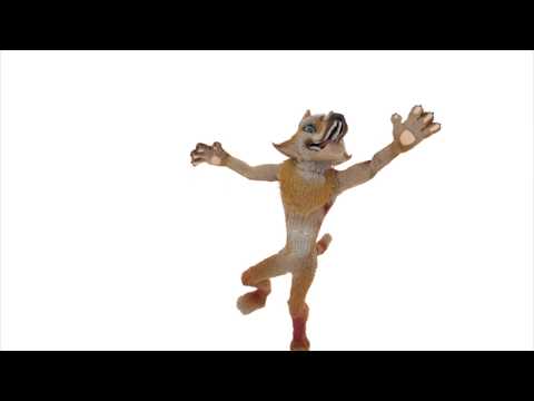

And this is my Character.
https://youtu.be/YOIN-1P6s5I

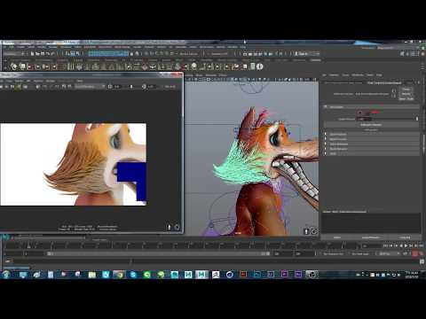

I don't know why my strands don't follow my guides after caching.

Here is my character demo, I failed to upload, sorry
In your video I can see the hair strands following the guides. Did I misunderstand the question?

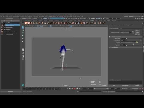

It might be not obvious enough. I repost another viedo.
Z6lrSgJoSQ4
My question is, I want the strands following the guides of animation cache.
Do I missed any steps?
Thanks for your help!
I can see it now. If you are caching the guides you have to use the AnimationCache operator on top of guides and under HairFromGuides. If are caching the hair strands then you have to you it on top of HairFromGuides. From your video it looks like you cached the guides but you are using AnimacionCache on top of HairFromGuides.
