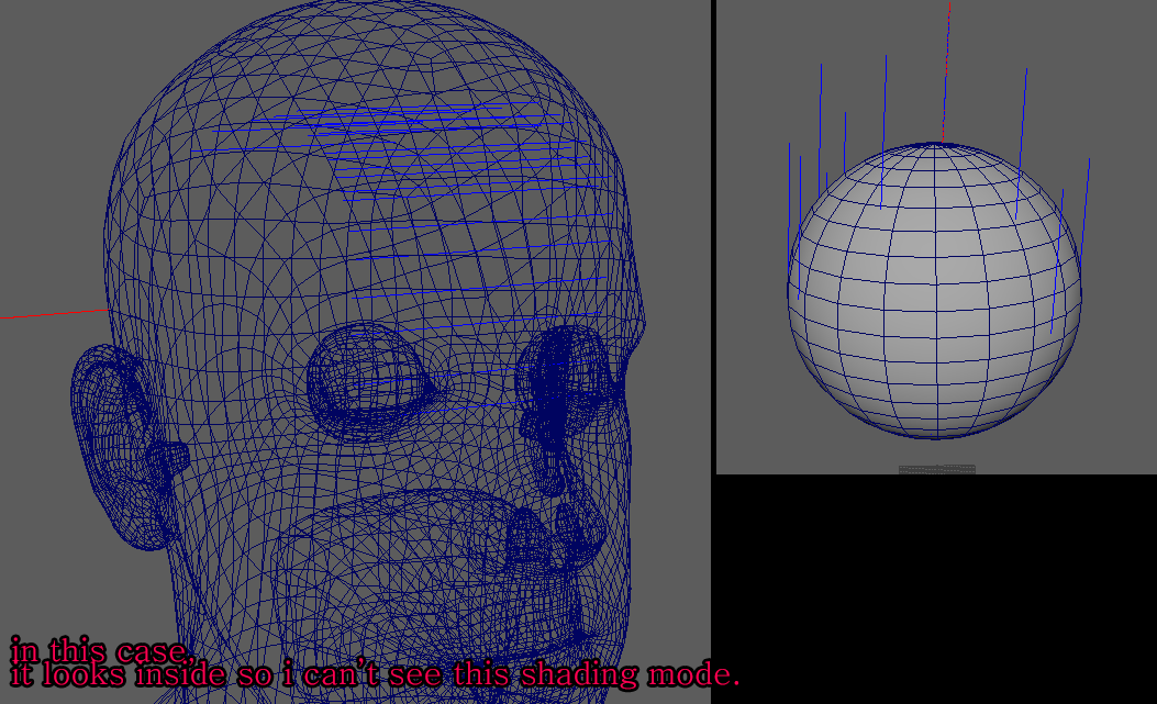

I have a problem using Paint Guide Tool.
when i use this, the hair guides are all same direction, so i can't control properly.
i want to plant guide correct direction (each normal direction).
"Push Away From Mesh" option is useless to this problem.
Autodesk Maya 2018, recent version of ornatrix.
not paint guide tool, sorry
"Plant Guide Tool"
I can reproduce this. Thank you for the report. This will be fixed soon, I will keep you updated.
