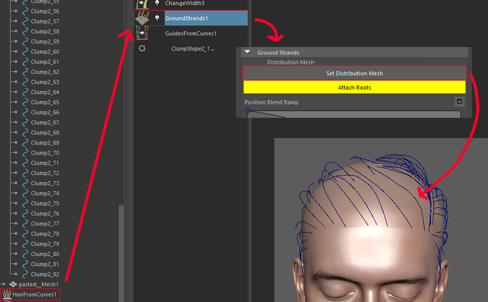

i make a curve from only Ornatrix "Curves from strands" (picture 1 [1.PNG])

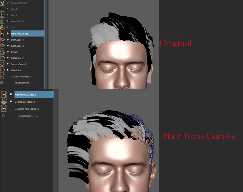

and then, "Add hair" with the curves (picture 2 [2.PNG]).

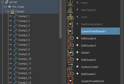

next,GroundStrandsnode from "Hair from Curves", i set distribution Mesh. (picture 3 [6.png])

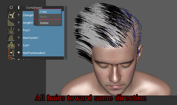

i added "hair from guides node".
at this time, i faced this problem. what they are doing?? (picture 4 [10.png])

After selecting the distribution mesh in GroundStrands you have to attach the roots by clicking the yellow button on GroundStrands operator.
