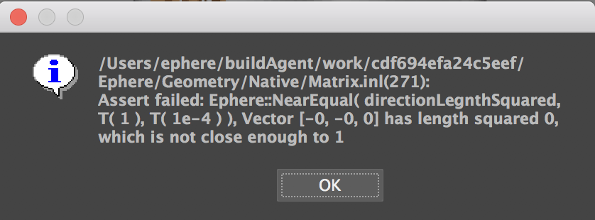

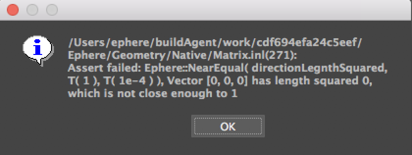

It looks like bounding box error is fixed but this other error still happens with the sample scene.
