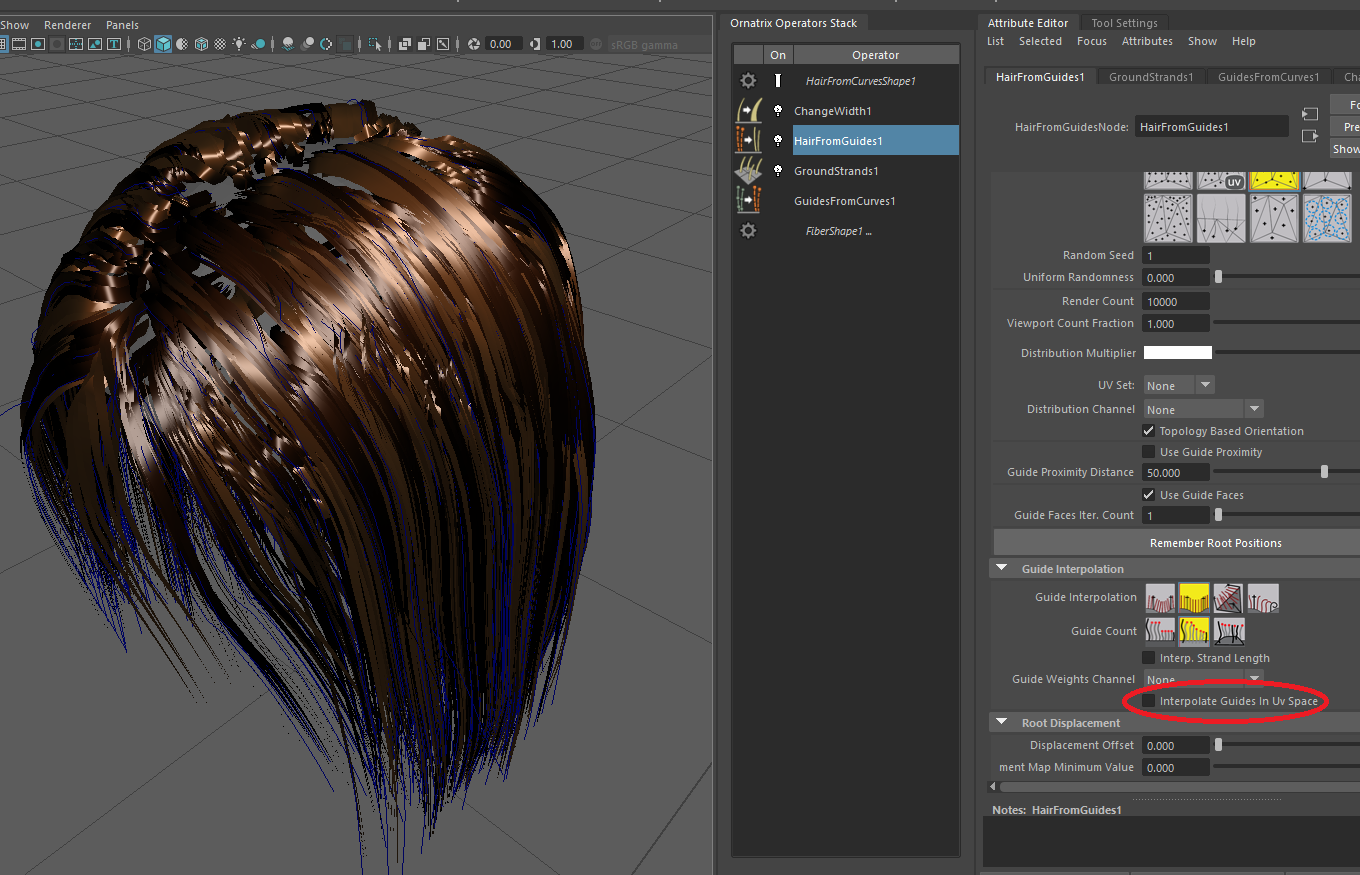

The problem is that your mesh scalp does not have proper UVs. As you can see in the script editor, there are two warnings: The one you already know "Guidesfrommesh not big enough" and "Cannot interpolate in UV space because mesh does not contain texture coordinates. Turn "Use UV Coords" option off to fix. //". The last one gives you a clue on what the problem is and how to solve this.
When creating hair is always good to create UVs for your mesh, you are going to paint texture maps and other masks to style the groom.
In the following image you can see how Ornatrix is working properly:
