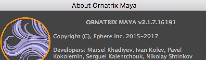

I'm experiencing constant crashes by just clicking around in viewport! See attached sample scene, crash log and recording.
Mac, maya 2018.3,
>crash.mov (3041074 bytes), >crash_log.rtf (5823 bytes), >test.zip (2886507 bytes),
Hi Yasinh,
Thank you for the files. I can't reproduce the issue on Windows but I will create a support ticket for this. I will get back to you as soon as I can.
Meanwhile, can you try the latest nightly build? Should be online in an hour or so.
Does Maya crashes if Ox is not loaded?
Tried that build and the crash is still happening constantly.
I haven't experienced the crash yet without Ox loaded.
Thank you for the info. We are looking into this. I will keep you posted.
This bug have been fixed on build 16445 and up. Please give it a try.
