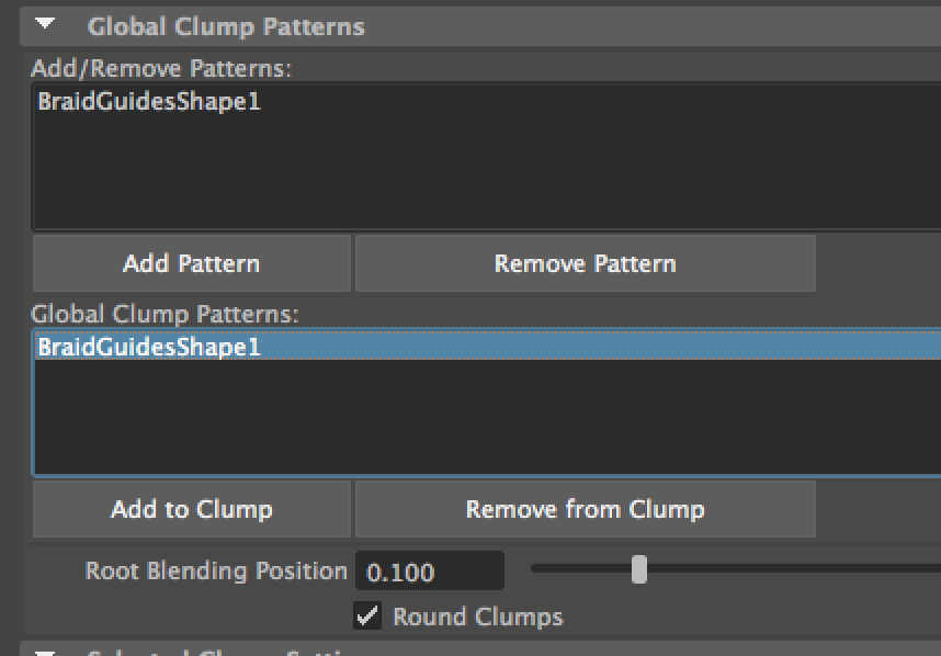

Maya crashes with error Segmentation fault: 11 when removing Global Clump Patterns. You can test it on your own sample scene.
On a side note, why is there two separate sections for adding custom patterns? Is the first one like a verification step?

First section is for adding clump patterns, second section is for picking patterns to be used from the first list. You can choose different patterns to be used for different clumps.
