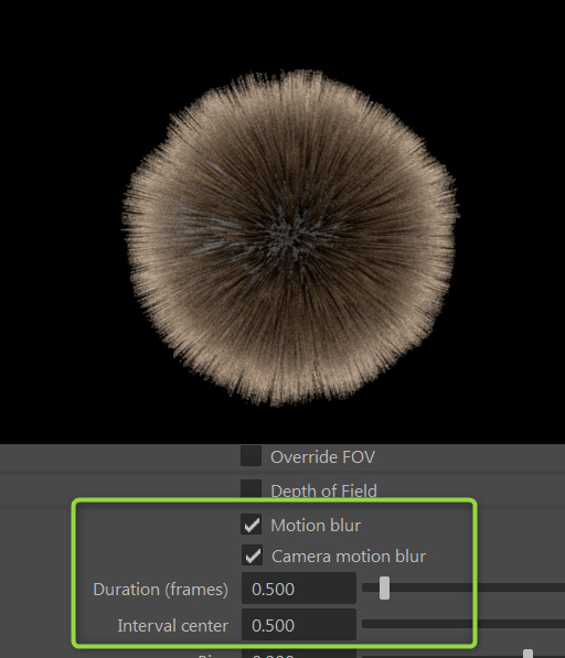

This is working well. Although I do have a question. in the example below I am exporting a frame with this command line
maya.cmds.OxAlembicExport(path,furShapes, ft= frame, tt=frame, s=1, r=True, v=True) ex: frame = 1001
It exports motion blur perfectly but with the following settings.
Vray Duration: .5 , Interval Center:.5

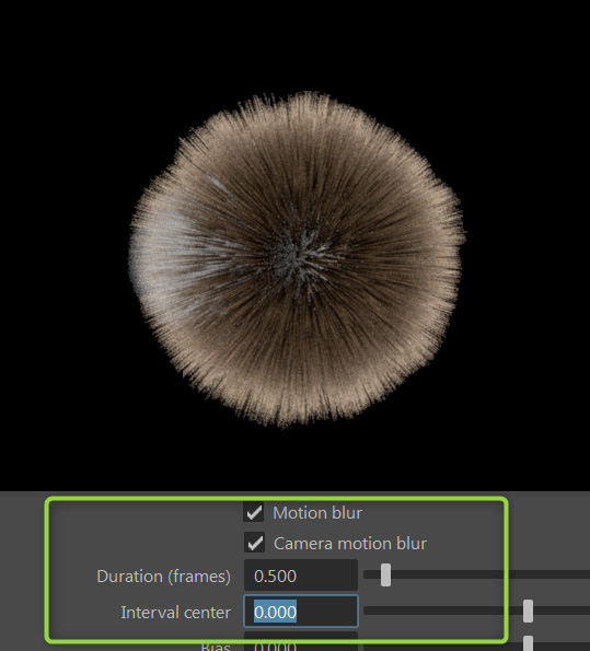

The issue is that we mostly render with an interval center of 0 so that objects don't slide from the track. can the export take that into account and let us slip back the .abc .5 frame to line up with our motion blur settings? I don't see anything the vray proxy node to do this.
thoughts on this? and thanks for getting this in so fast! It helps a TON!
