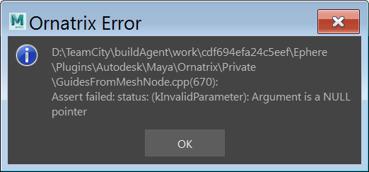

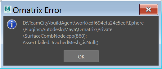

Some Random Loading Errors these errors didn't seem to affect the asset or the shot but was more of an annoyance. (see attached images and txt files)

Some Random Loading errors: I will get back to you on this errors later.
