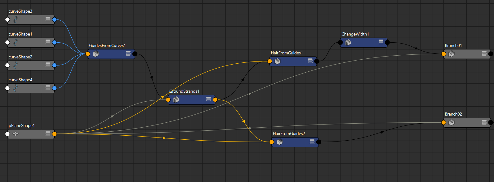

Or, you can just select GuidesFromMesh or GuidesFromCurves and use the following MEL script:
string $selectedNode[] = `ls -selection`;
OxAddStrandOperator2( $selectedNode[0], "HairFromGuidesNode", 1 )
This script will create a new branch starting from the selected Node in the NodeEditor or the HairStack and add a new HairFromGuides node. This way you will have a second hair object driven by the guides of the first hair object. The Node Editor should look like this:

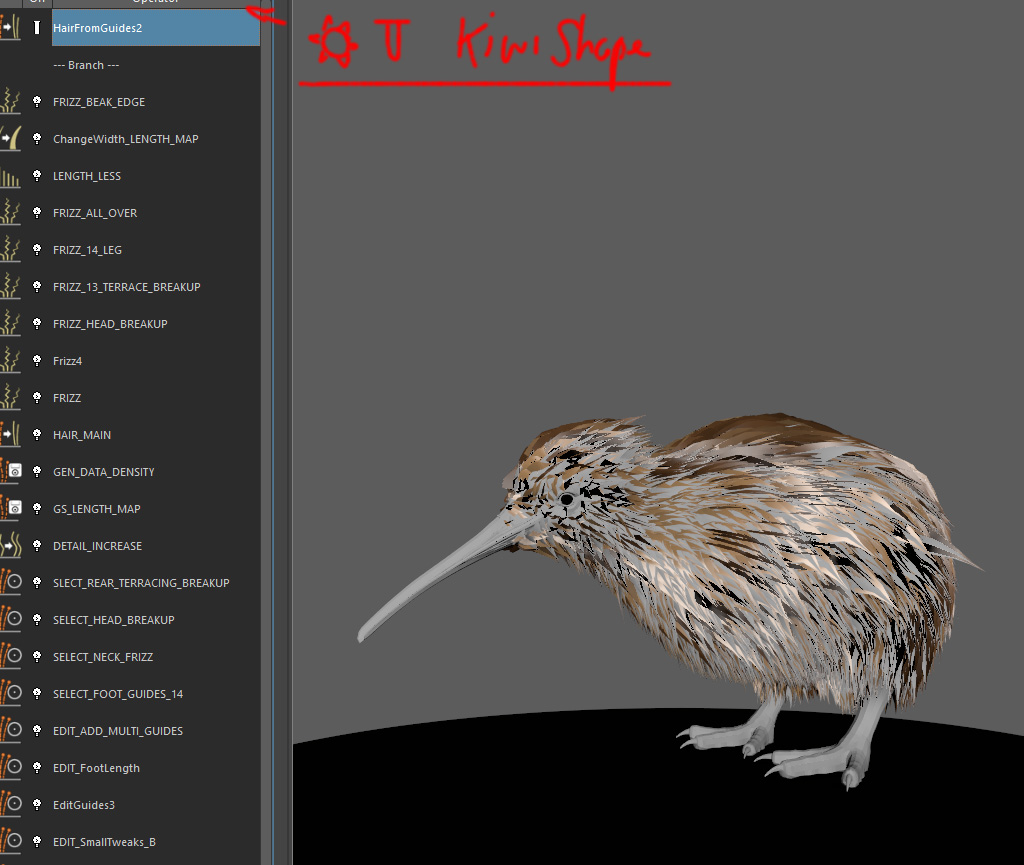

The HairStack should look like this, notice the "Branch" label, this is where the new branch starts, you can double click to switch to the shape of each branch:
