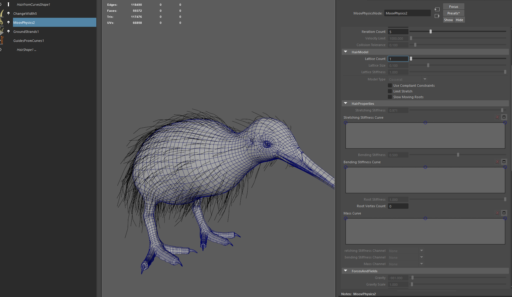

I am curious though, when I opened my asset scene and added a moov node (also onto a very clean setup, just guides from curves, ground strands, then moov)
Most of the settings are greyed out. I have noticed this happen from time to time, but never known the cause.
I have attached a pic of the issue.

Thanks Ivan, I really apprecaite allt he work going into solving this. nb. the greyed out attributes have dissapeared on reloading the scene

I have just noticed that there are other bug related to the Moov node. On reloading scenes and on turning caches (above moov nodes) on and off, the settings of the moov node are reset. The greying out of attributes also appears randomly, and preset's dont seem to apply properly across all attributes. I will try to switch account to post these in defects soon.
