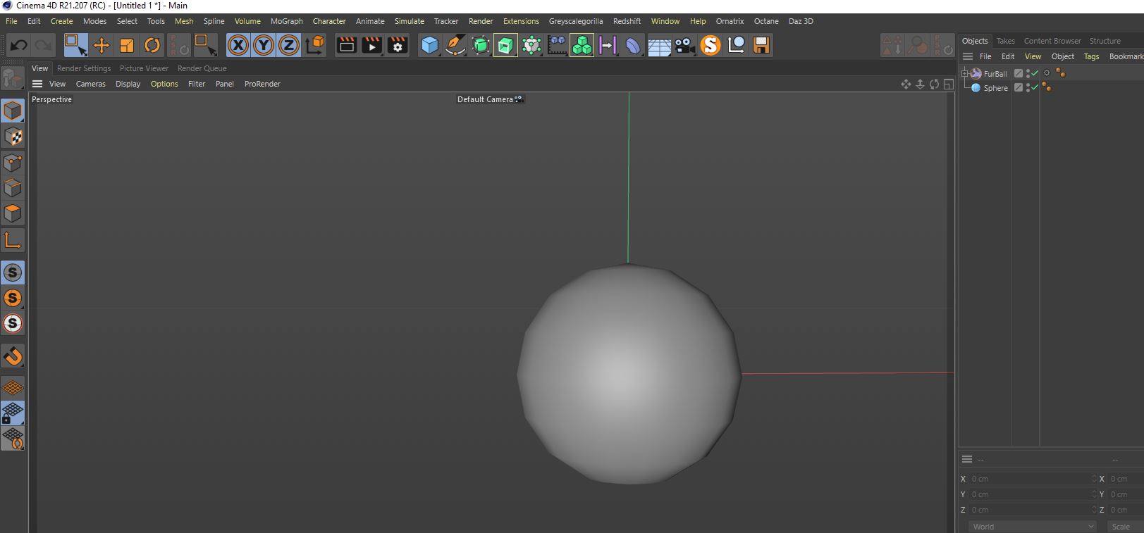

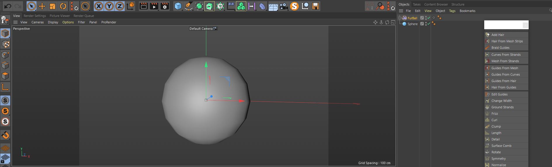

I was so excited to dive into learning Ornatrix and can't get by the first step! I've simply added the furball hair to a sphere, but it does not show up on the actual sphere (making it editable is the same). Any ideas as to why? Many thanks!

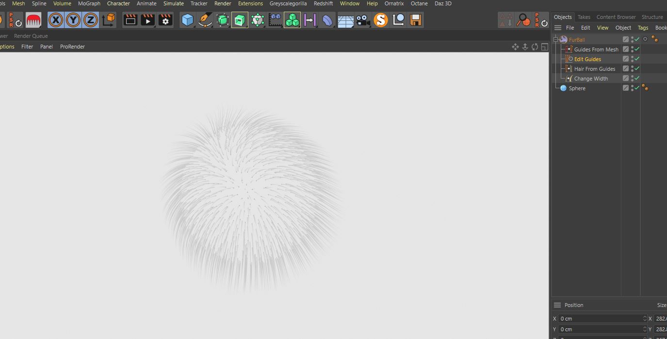

The hairs will also show up in the render view, but just not seeing the actual hair guides.

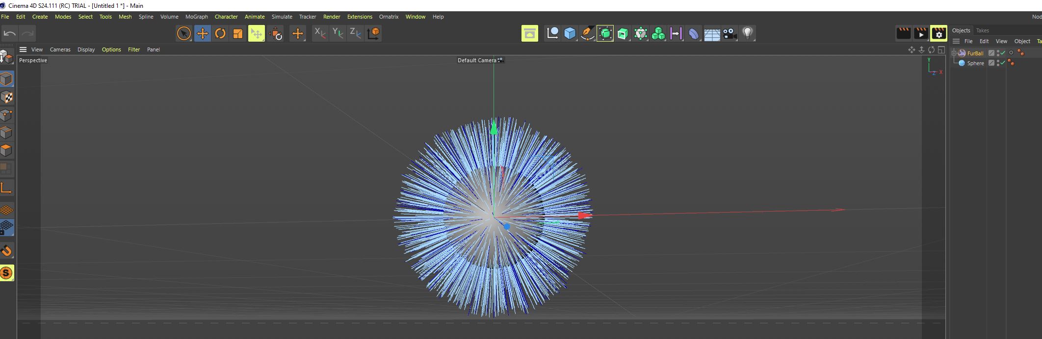

I tried R21.207, with Ornatrix demo. It seems to work fine here. I can see the hair:
Hmmmm I wonder what it is that I can't see them in the R21 version. And yes that's correct - I can see the guides in R24, but not R21. I'm using R21.207.
