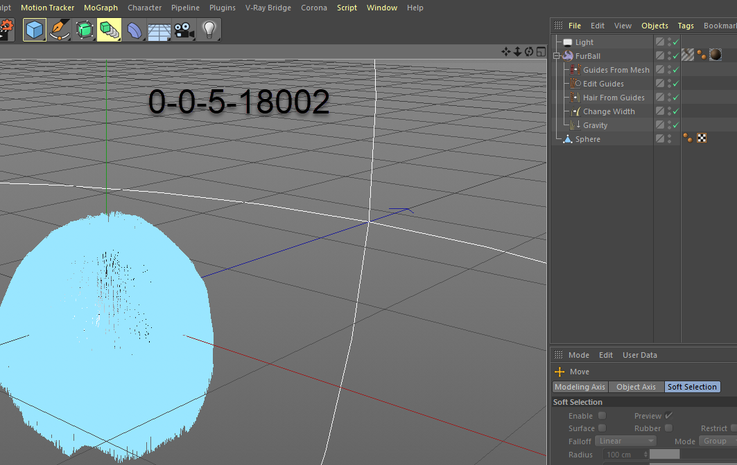

Nightly 0-0-5-18002 The hair is not rendering at all. I initialy took it that the basic operator stacks where added by default to render hair but they are not, so I added default hait material, still not rendering. I tried to adjust the width operator thats not updaing the hair material. For some reason unless Im missing a step no hair is rendering? Attached Files: My Web Site - ArtStation |

| Hi. Yes ny bad, curves from strands wasnt in the the stack by default for some reason, so It wont render without that. Thanks, Dan My Web Site - ArtStation |

| @Dan, while porting the operators to modifiers we stumbled into a C4D limitation that broke hair rendering. we decided to keep only mesh hair to complete the port asap. Maxon opened a bug report on that limitation, we hope they can fix it soon. But good news is that we managed to implement a workaround, already available in v0.0.6. Just to clarify: You need to manually add Curves From Strands (spline hair) or Mesh From Stronds (polygn hair) to actually render. |
