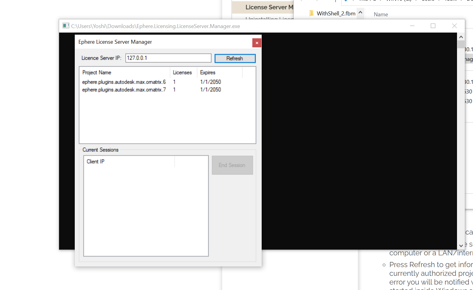

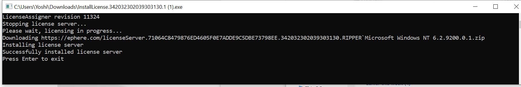

I have uninstalled Ornatrix, installed LS ( see LS_install.jpg ) seems no error. Tried Max the problem persist. if i try to do anything on modifier stack "This computer...." comes up then mdifier stack is frozen. I run LS manager ( see LS_Manager.jpg) shows no session here. any suggestions appreciated, thanks. yoshi

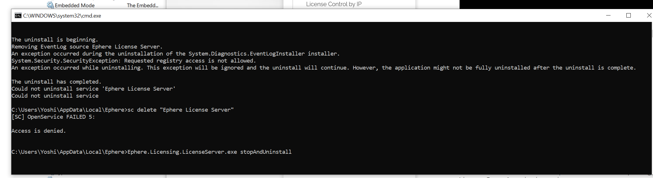

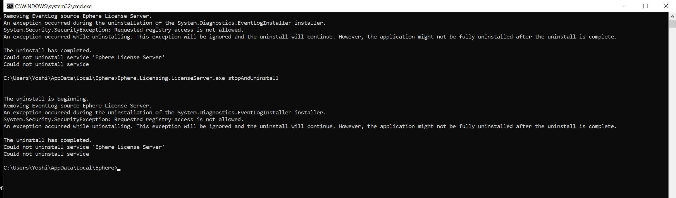

  3. Uninstall the license server, The same problem uninstall begins but prompt comes back "Could not uninstall service" ( See attached) Checked the list of services and it is still there
  4. Reinstall Ornatrix.
I stoped the service before initiating uninstall command. the second time I started the service before uninstall then the prompt comes back with "Could not stop service" ( See attached)

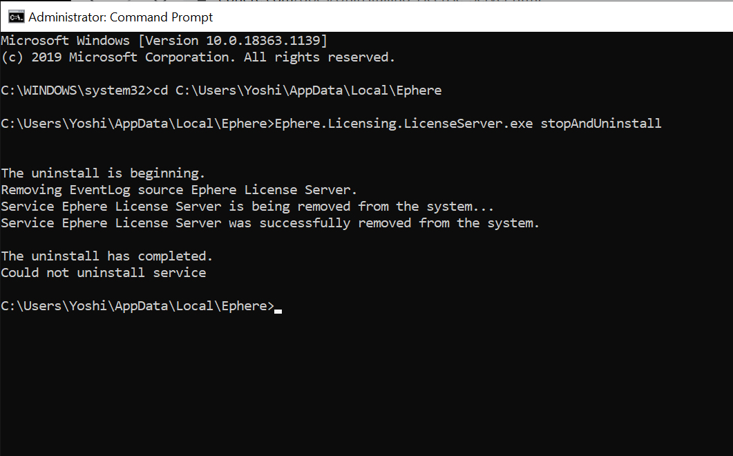

Please make sure to run CMD with admin privileges. This is needed to uninstall services.
OK,
I unistalled Ornatrix from Max and Maya
WITH admin privilages  uninstalled services (See 10_22).  CMD says uninstall has comleted but couold not uninstall services?? what does that mean?
Checked the Serivices list and could not see Ephere LS there.

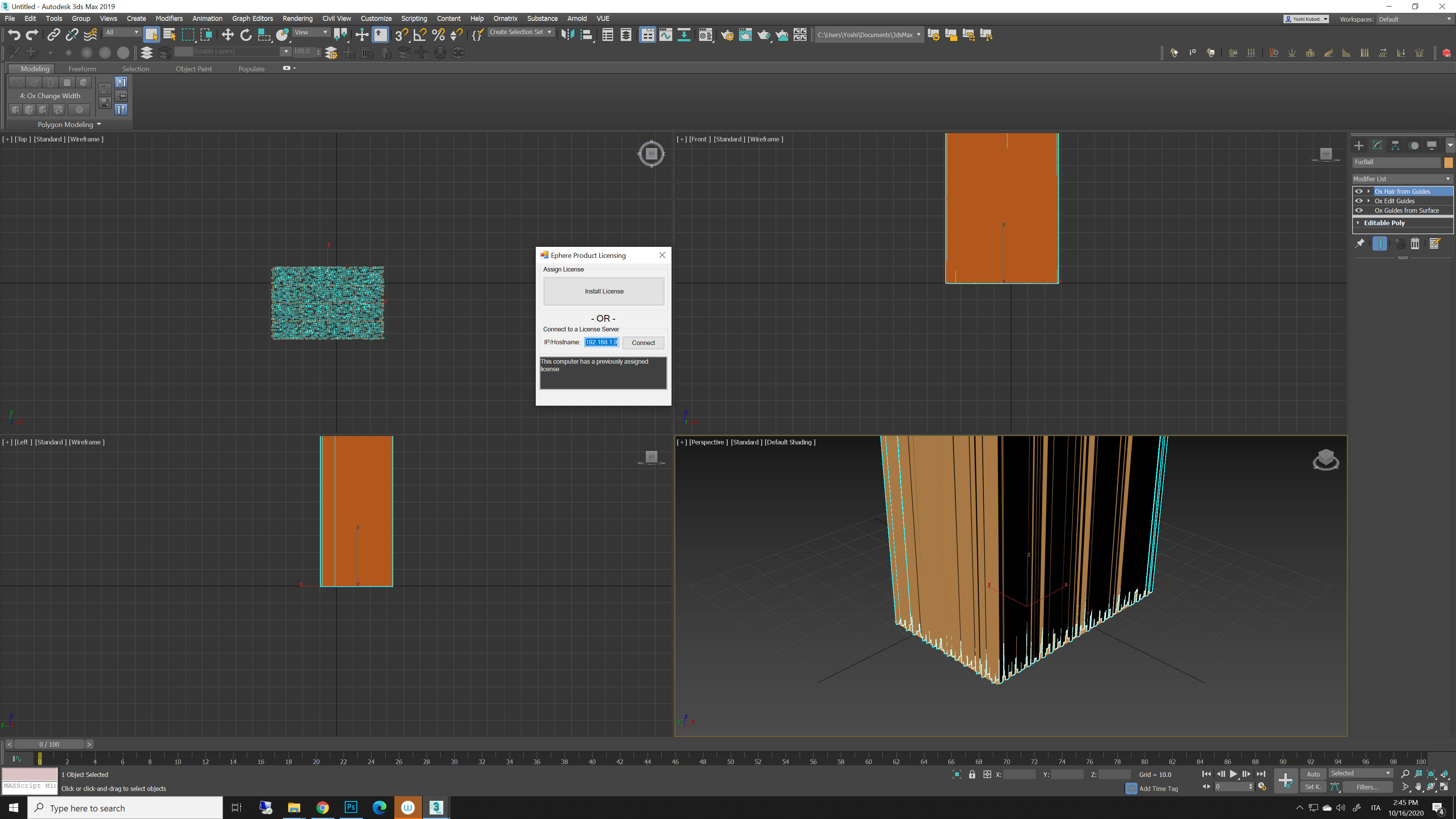

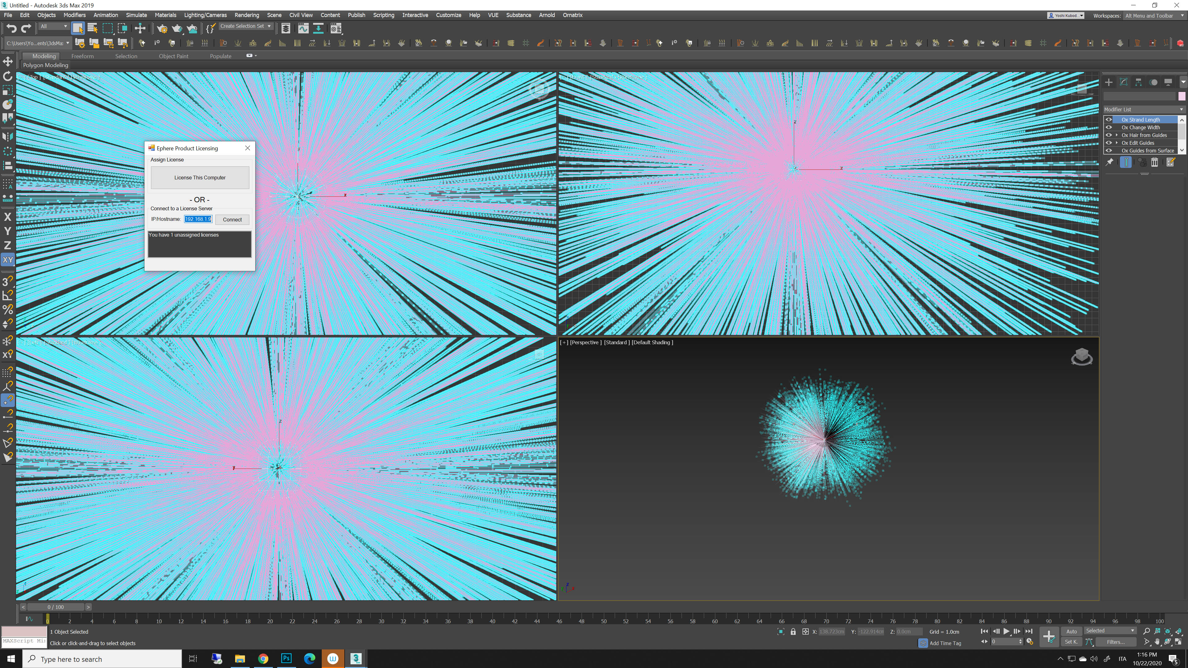

installed just Max version when i start Ornatrix and create hair i get 10_22_A so click "License this computer" Is this right? I suppose.
And then again I get 10_22_B if I click anywhere in the modifier stuck.
I'm desparate at this point. what can i do?
yoshi
Image 1Image 2
I assume you're installing the license server on the same computer as Ornatrix? If so, the IP in the license dialog should be 127.0.0.1
If it still doesn't work please see what the license server manager shows on this computer: https://ephere.com/docs/License_Server_Manager.html
If it doesn't show any licenses please install the license server directly from the downloads page link.
I see that you already showed the license server manager picture, please just try it again to make sure. The biggest thing for me is the IP address you entered in the licensing dialog, it should be 127.0.0.1
Ok, I unistalled Ornatrix, Released license, uninstalled the license server, then before reinstalling Ornatrix I installed the license server from the download link and directed to  IP 127.0.0.1.
And then installed Ornatrix for Max and it WORKS! Thank you very much for your help.
