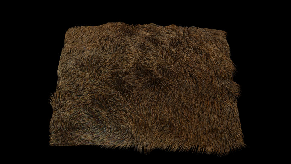

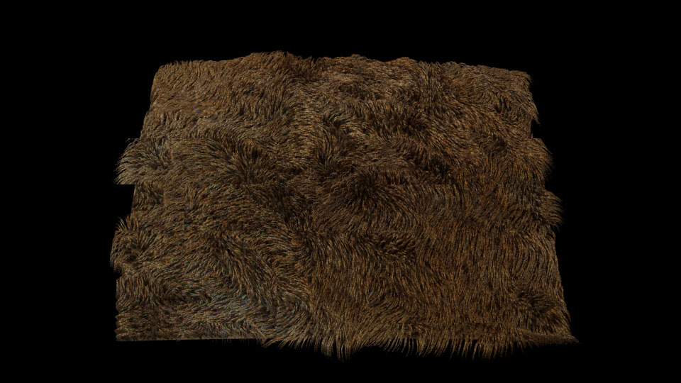

Hi there, I'm having serious problem with Distributed Render with Vray. My Vray version is 2.4 and ornatrix version is 2.2.5.0 I had hair differences in render buckets for each seperate computer. (3 PC's) I was able to reproduce the problem in a fresh scene. I'attached my scene file and my render results regarding DR render.
I also attached DR render node render pass that I rendered in vray render elements.
I tried to solve this by adding OX mesh from strands modifier. But also it didnt work as well. While you're trying my scene please turn off the mesh from strands modifier. I'm trying to render the file with 3 PC's all software versions are identical. (doublechecked) All three work on win7x64. 1xi5 1xi7 and 1x Xeon cpu's I don't think this is a Vray related problem. The differences are the way hair strands are produces. They point to different directions. Please jump back and forth between those 2 renders you'll spot the differences immidiately. I have a big job at hand and I have to finish this week. So any help or workaround would be great. I have to use the DR because it's going to be a massive sized render for print work. Please help,

This is likely because the hairs are generated differetnly on every machine depending on what type of hair and guide generation you are using. Try using the Remember button in Guides from Surface and Hair From Guides. This will be sure the same generator is used on each machine.
1. Press the Remember button 2. Do a render locally so tha the hair is generated 3. You should be all set to go to the farm full frame or with DR
