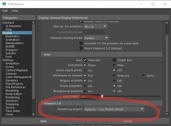

Thanks for the answer, Jeordanis! I changed the display properties in Maya to OpenGL (it was DirectX) and now I have a better performance.\
