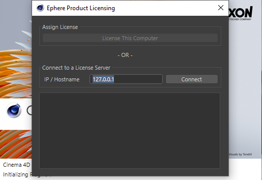

Since i install R23 i have a popin product licensing, but i really don't know how to active it. The license This Computer can't be push and i don't understand the ip / Hostname stuff. Need help please ;)
Can you show me a screenshot?
Sorry i forgot to attach it previously
What happens if you click Connenct?
nothing, the popin disapear and come back with the same message
Check if your antivirus or firewall is blocking the license server. It looks like something is preventing it to connect to the internet.
Nope just check and nothing like that.. i hhave a r23 license, everything work well, every plugin, but not ornatrix... T_T
Let's try this: Install the License Server directly from the download page.
https://ephere.com/plugins/maxon/c4d/ornatrix/downloads.html
See the links under "Install License Server Only" and download the one that correspond to your OS.
Thank you! it work!

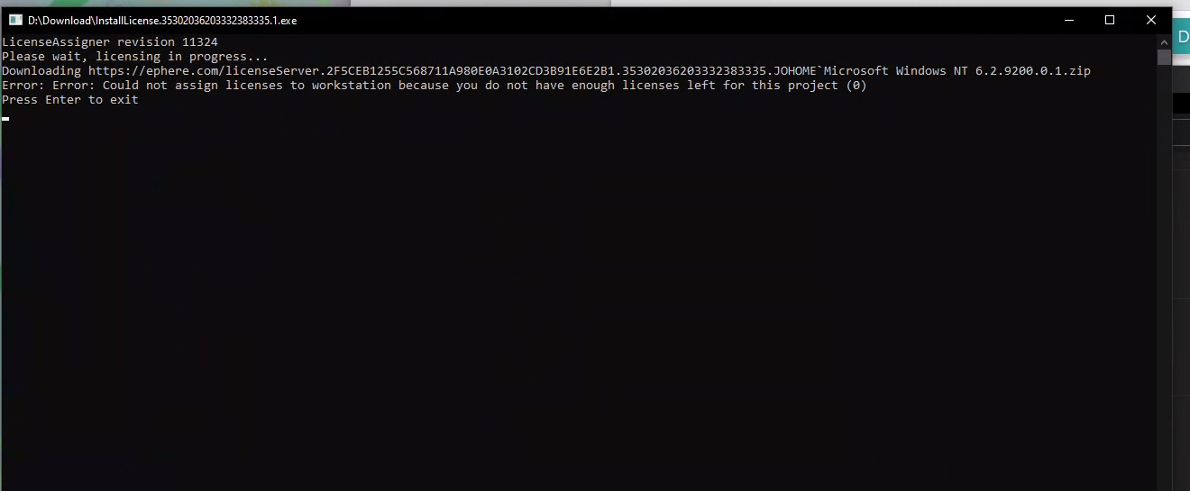

Hello... today i try to install it on another computer to see if it can work but this time the license server say that i don't have enough license.. so i can't use it on different computer (even if on my master computer the plugin don't work at all)?
We don't have the possibility to shtudown the license on a computer to use it on another?

The licensing issue should be fixed now. Please give it another try.

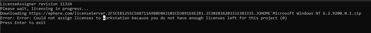

This is what is happening. You have 1 license for Ornatrix Cinema 4D. This license is already assigned to RONIN161-JH. This is why it says: "you do not have enough licenses for this project" meaning that you do not have enough licenses remaning. So you will not be able to use Ornatrix in a second computer unless you release the license from RONIN161-JH first. The online licensing system that would allow you to use the license online and move it between computers like you expect is not implemented in C4D yet, only in Maya and Max.
Now, you are getting this error in both computers, right? The license server gets stuck like this after a Windows update or when you change some hardware in your computer. It can also happen when you replace your modem. In this case you have to release your license and reinstall the license server. Instructions here.

And to clarify, if you are still getting the licensing error follow the instructions from my previous message where I explain the problem. You just have to release the license.
thanks for the reply i will give a try tomorrow!
(And yes thank you! it work fine on my other computer, i just realese the license and the plugin work fine here)
