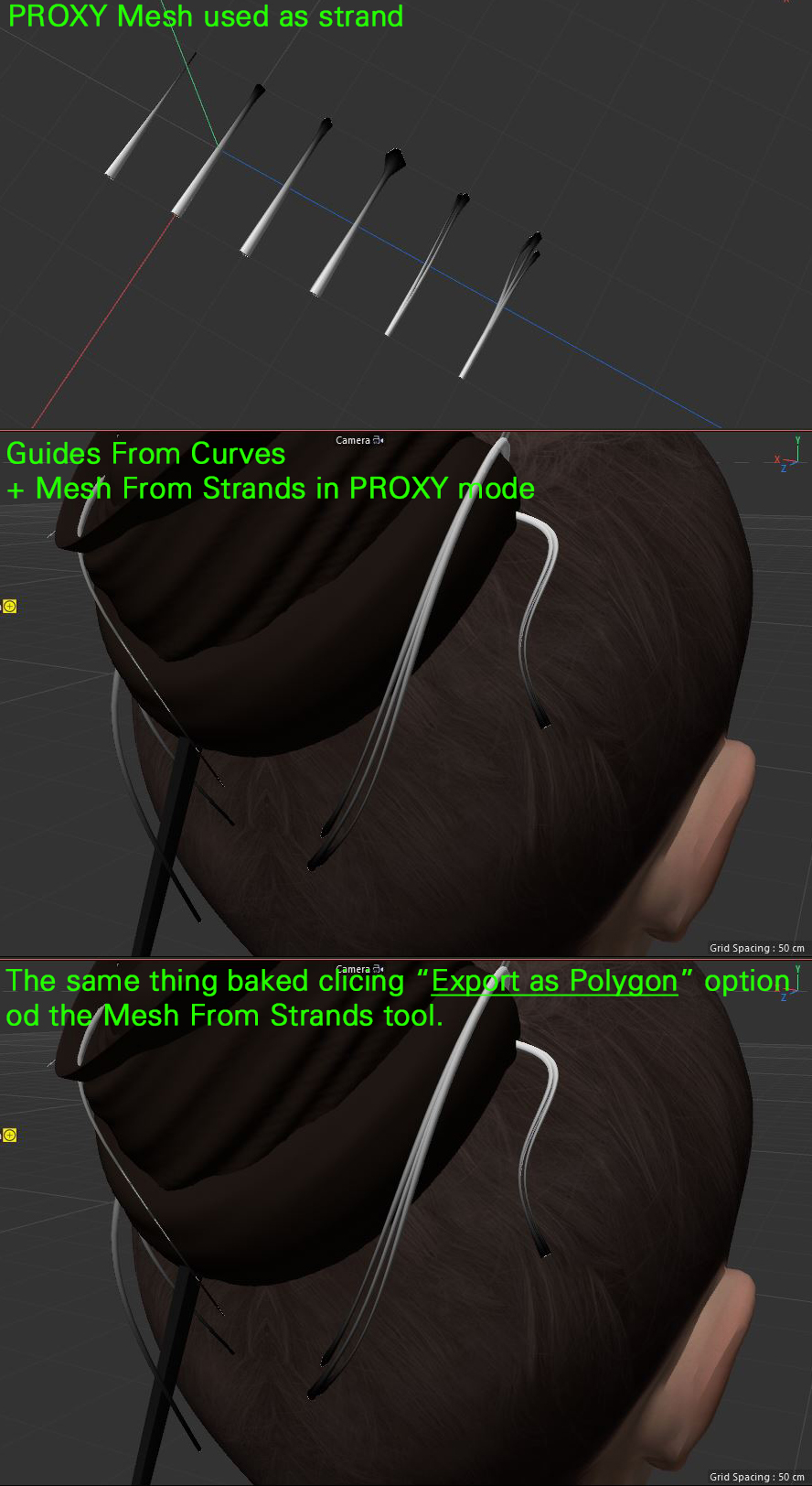

I'm currently experiencing a new issue with Ornatrix V3 in the "Hair From Mesh Strips".
Indeed, the direction of my stripes is sometime wrong, despite of a good and verified geometry direction.
As you can see below, I use these PROXY in a "Guides From Curves".
The white part is the root and the black one is the tip.
Setting appart the issue I pointed in another thread concerning the "Mesh From Strands Direction Issue", you can see that everything is OK until I bake it.
BUG-HairsFromStripes_Direction

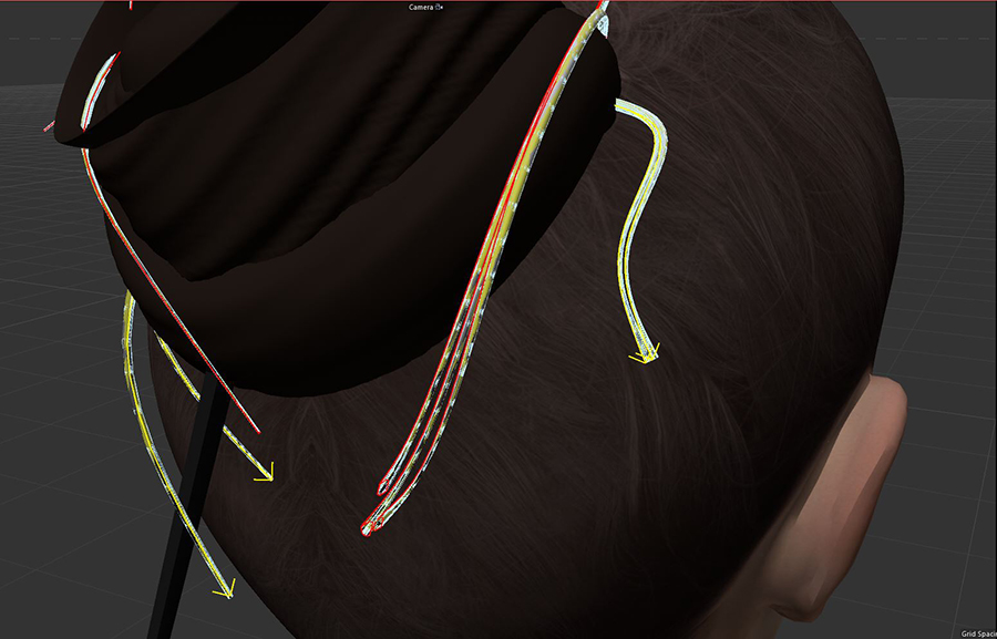

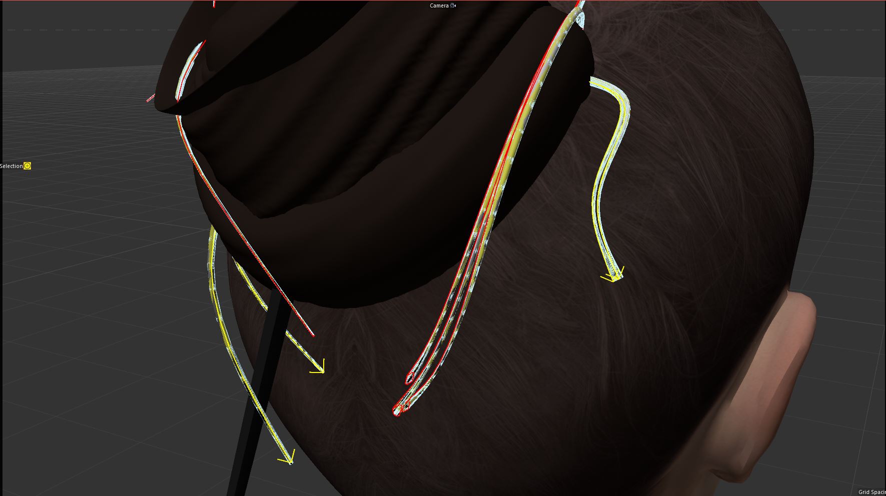

But when I use the baked mesh in "Hair From Mesh Strips", some stripes are inverted :
Hair From Mesh Strips - Result
This enoying because it's random, so each time I change my Strips, I need to reinverse some of them manually.
But the most strange and boring issue is that sometime, the stripes are automatically reinverted when I render the scene, so I can't fix it definitively.

Are you rotating the strips using the Rotate Strands/Rotate Selected Strands button in Hair from Mesh Strips?
I'm using the UV Flow Down option to rotate all the strips at the same time. This will set the direction from root to tip based on the UV direction in the strips.
This seems to work fine. Rendering the scene doesn't change the direction of the strips, though I don't know how you scene is setup because it renders all black for me(In the picture viewer).
